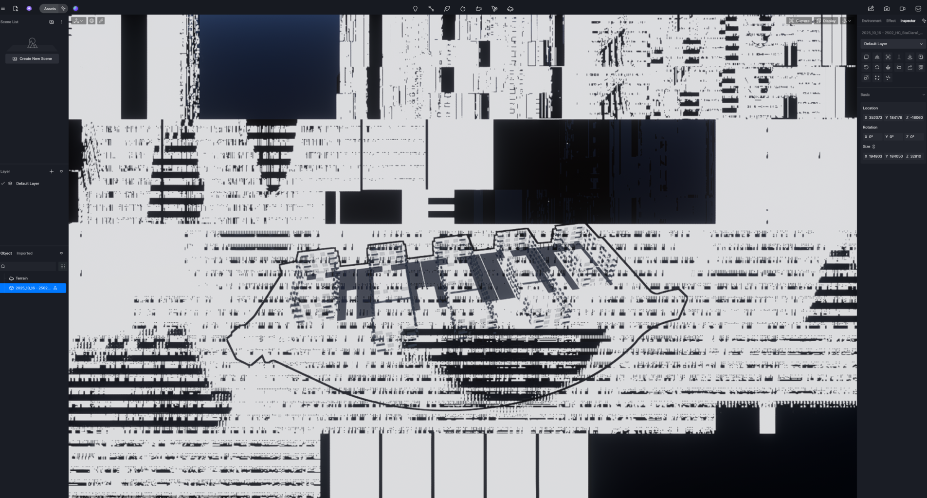

Problem in ReLoading file
**D5 Render Version: 2.11.1.0620
**Graphics Card:RTX 2080 Ti
**Driver Version:581.29
**Issue Description:Graphic issue after reloading File. It was working fine a few hours ago…
Please: urgent!!
Thanks
Hi there
Does this only occur after the model is imported to D5 Render? Usually, this occurs when the polygonal value of the model is too high.
  • Try to hide the model if the issue persists
  • If hiding the model, makes the glitch disappear then try to reduce the polygons by purging them from your 3d Modeling software.
Thanks, Clov.
Thats what I suspected,too… The file had too many Groups from Archicad…
Solved
Thank you!
