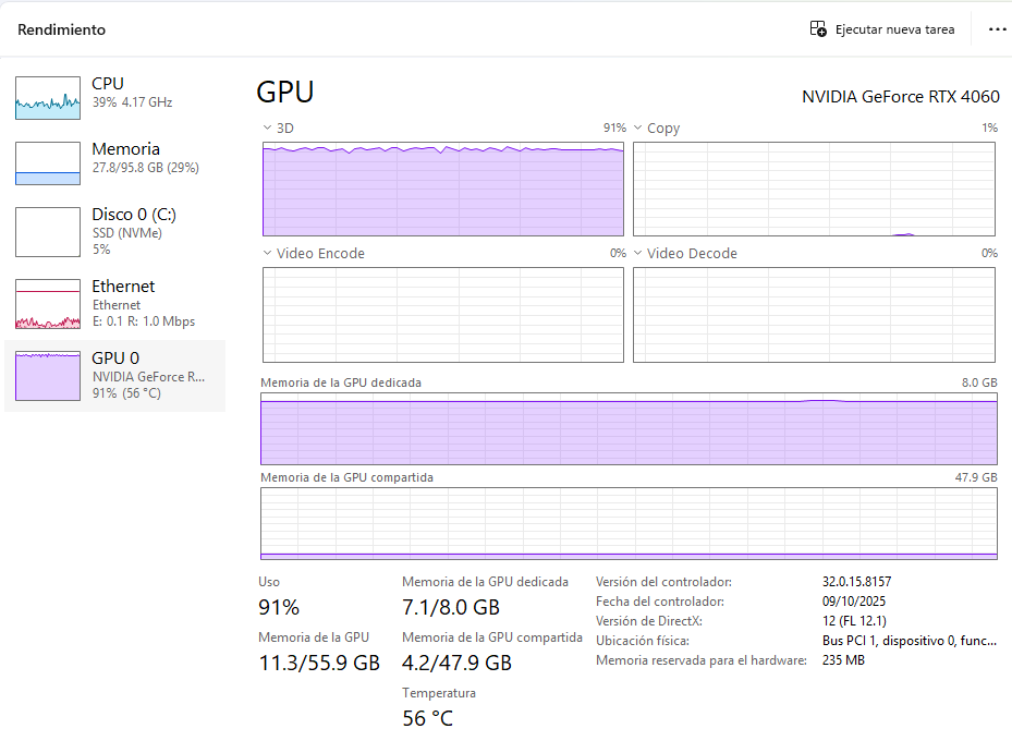

Hi, I don’t have any overheating problems when using D5. My graphics card is an RTX 4060 8GB, 96 GB Ram. I think the difference is that it has a triple fan; even after an hour of rendering video, the temperature is 56°C without exceeding 60°C.
