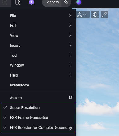

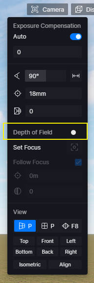

Hi @ibrahimalameer89
You can try checking the following:
  • If you have Depth of Field enabled, you can try disabling it.
  • Try enabling/disabling: Super Resolution, FSR, and FPS Booster
    2.11 SR, FSR, FPS BOOSTER
  • Switch to Perspective Mode instead of Two-point perspective
If any of these did not improve or work (please try them first and confirm), you can send us this specific file and your logs. You may send it to support@d5techs.com and have it titled 2.11 Clov-Forum Pixelated Image Quality
Let me know if you have sent it.
