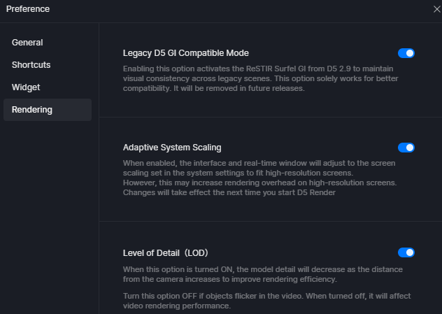

Captura de pantalla 2025-12-19 133512

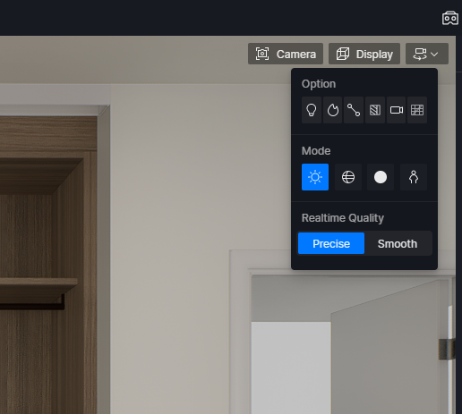

Captura de pantalla 2025-12-19 133812
Hello, does anyone know why the path tracing button disappeared, including for the preview? It used to appear before, but today it’s gone, even the option to enable it…

In D5 Render 2.11, real‑time path tracing (RTPT) has been made the default global illumination (GI) system and is enabled by default in the render engine. You no longer need a separate toggle like before — it operates automatically.
