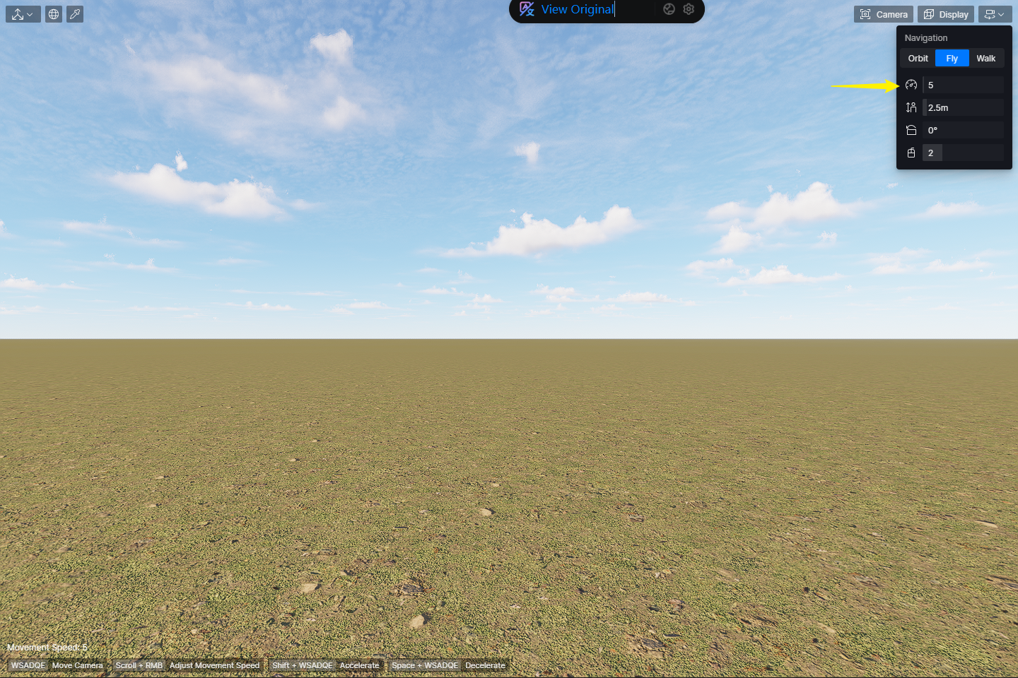

- What is the Fly Speed of this specific file?
- Did you perhaps press shift while pressing WASD? Pressing shift will speed it up.
Hi Clov,
It occurs randomly, I went to another project to get an asset from that project and then came back to the project I am working on and it was fast. As for pressing Shift + WASD, been using D5 Pro for 3 years now so no I don’t mate, but when I say fast I’m not talking ‘shift’ fast, I’m talk supersonic fast. My movement speed is the same as yours 5, I’ve moved it to 1 so I can work.

I figured it out. It went back to normal, than an hour or so later it went super sonic again. After checking, I noticed the speed in navigation went from 5 to 75 for unknown reasons. I put it back to 5 and all is well. Why it changes is what needs to be looked at.
