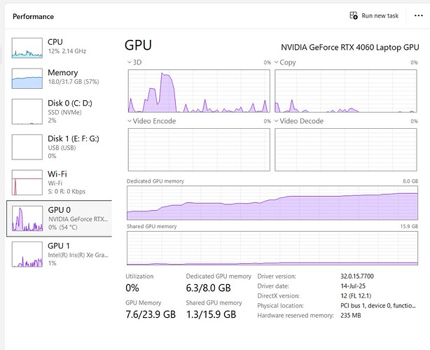

I am running RTX4060 with 32GB RAM. The GPU driver version is: 577.00 Released on July 22 2025

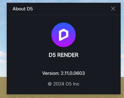

May I know which version of D5 you are currently running, 2.11?
- If you’re running 2.11 and these files were normally opened in 2.10 then it might be one of the hottest issues that we’re currently solving right now.

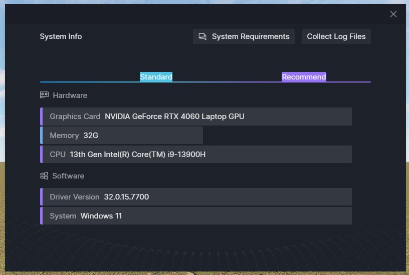

- System Info

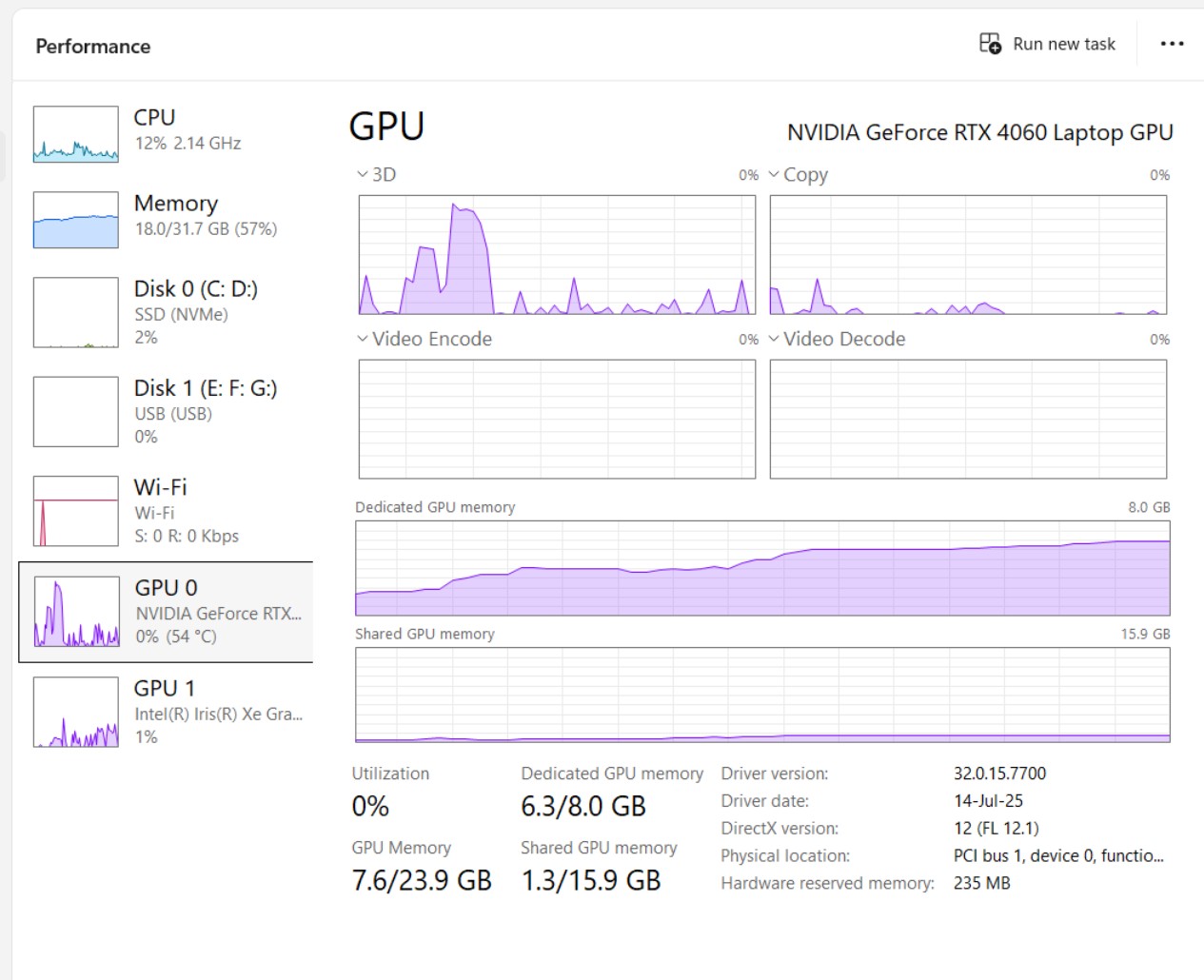

- VRAM - Open your D5 File while accessing this portion

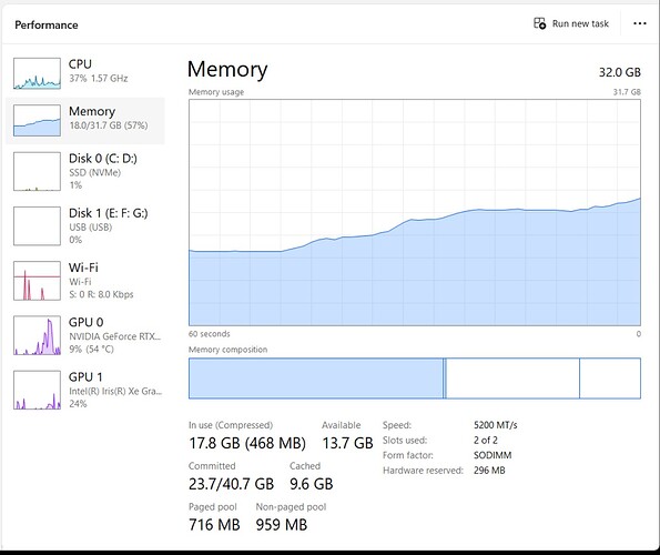

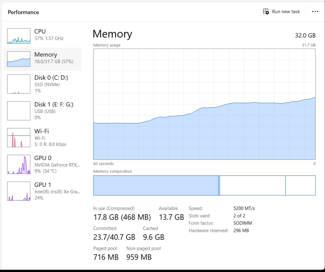

- Memory Speed
Thank you for your reply. Please find the requested screenshots attached.
I’d appreciate your advice on how to resolve this issue so I can complete the project within the required timeframe.

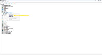

Can you try disabling your Integrated GPU, or making sure d5 is using your RTX GPU? It seems like it’s exerting more effort than your dedicated (RTX) GPU, which should be the other way around.
Set D5 App to use your RTX GPU
Disable iGPU
Already done as shown on your screenshots above. Not sure why it is showing that the integrated GPU has a higher load. Also, I took the screenshots while the software was loading the file. Obviously, I can`t take screenshots when the file is loaded because it crashes on the loading screen.
I assume disabling didn’t help?
