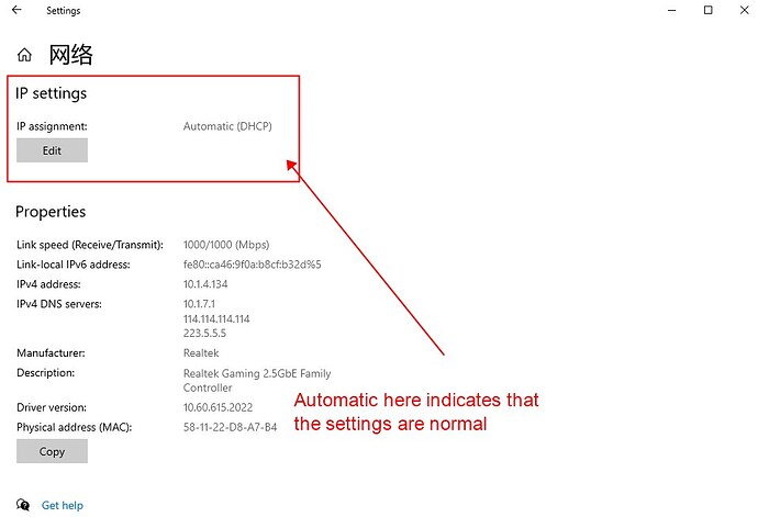

Hi there. Please check your inbox, I have sent you the D5 ports for our asset library which can be used for whitelisting. Nevertheless, I also want you to try several probable solutions for this fix:
Windows Settings - Network&Internet - Ethernet - Network - IP Settings
