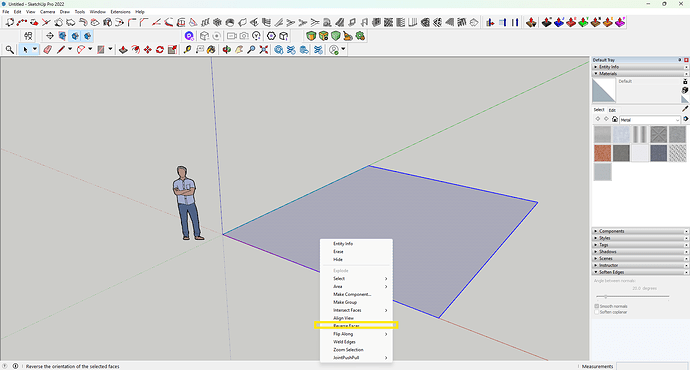

Hi there, Please check if there is an overlapping surface on the Sketchup model which may sometimes cause similar issues. You should also try to reverse the face of the material in the area as shown in the screenshot below. Please let me know if the issue persists.
Thank you! Reversing the faces in the model works!
