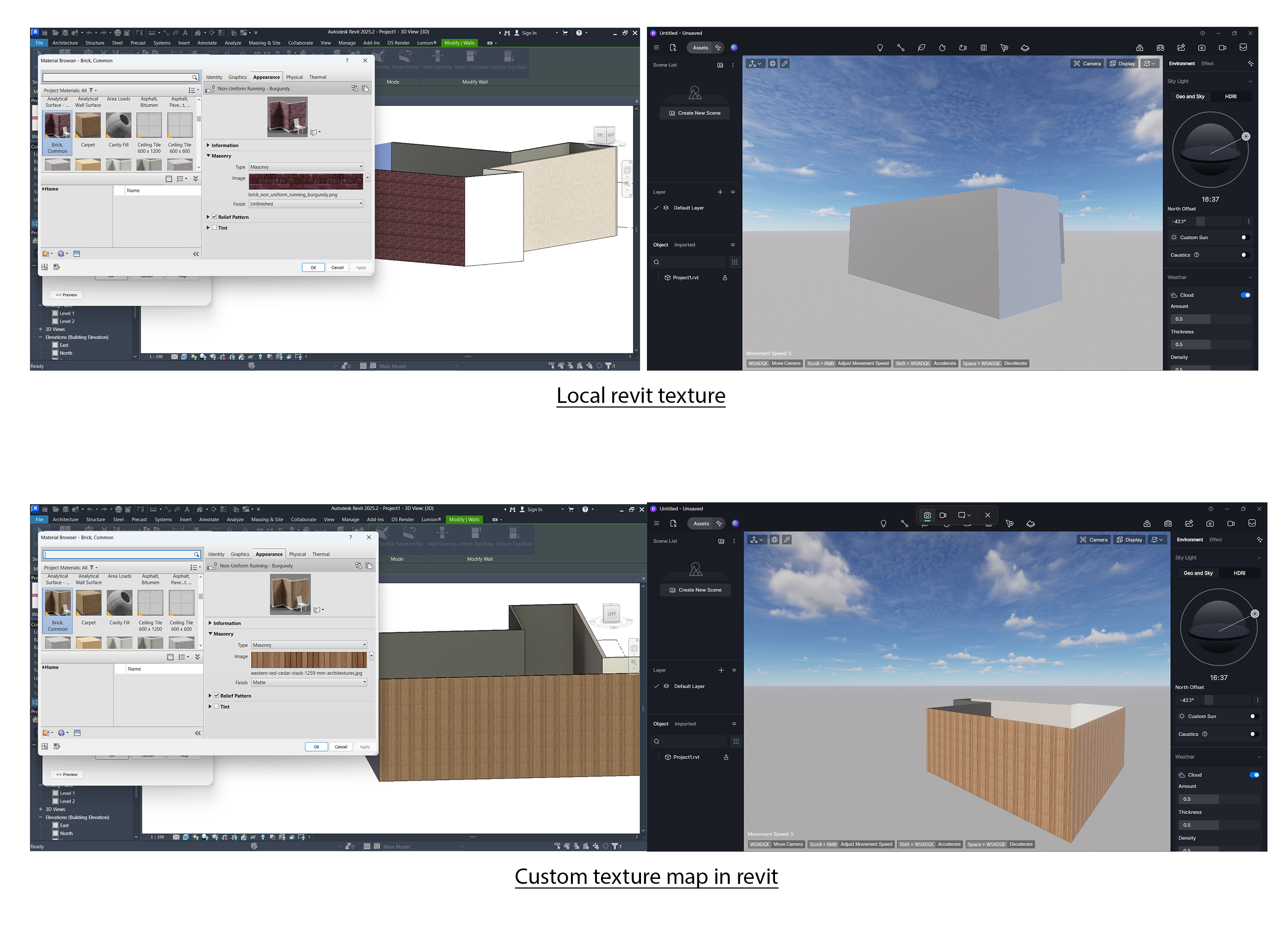

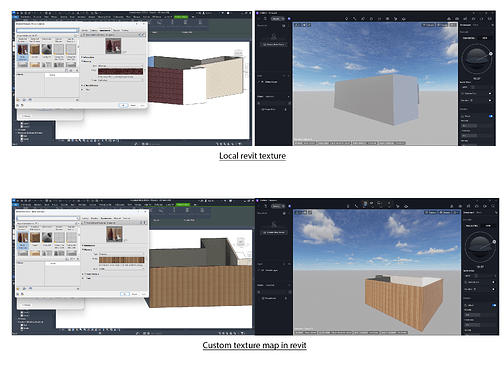

I apologize for the inconvenience. Currently, a problem exists where Revit 2025, running on Windows 11, is unable to recognize internal or local textures. Thus, prevents proper synchronization with D5, causing these surfaces to render white. Custom textures (importing images to the material) , however, are unaffected.
We will be addressing this issue in subsequent releases.
