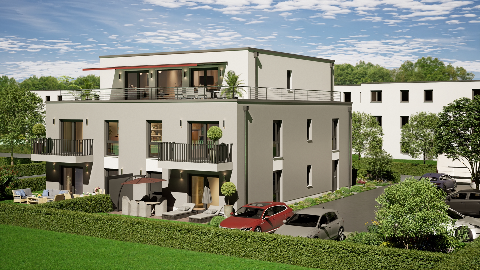

Hello,
I just want to make the shadows brighter.
How can I do this?
For example, the shadows under the balconies
are too dark for my liking.
I’m still working with a different software program.
In that program, it’s possible to set for each light source
whether it casts a shadow and how light or dark
that shadow should be.
If this isn’t yet possible in D5,
I’d like to request that this feature be
added to the program.
Bye,
Andreas

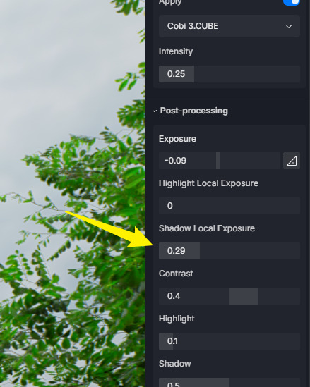

Hi @a.drexler
Have you tried mofying this parameter?
