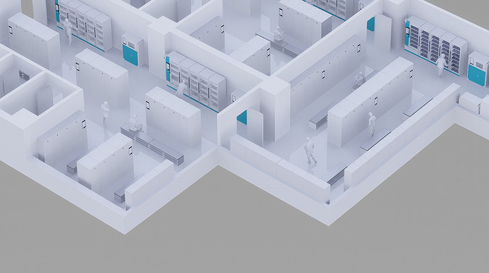

How to fix this issue ?
I changed location of D5 project folder to another location. Then I brought it back to original location but it is still white.
Hi there, have you adjusted and saved the material in D5? And you need to make sure you moved the entire D5 project folder, if some of the subfolders(eg. asset) weren’t moved together, you may lose the materials.
