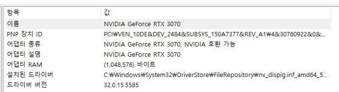

Graphics Card:
Driver Version:

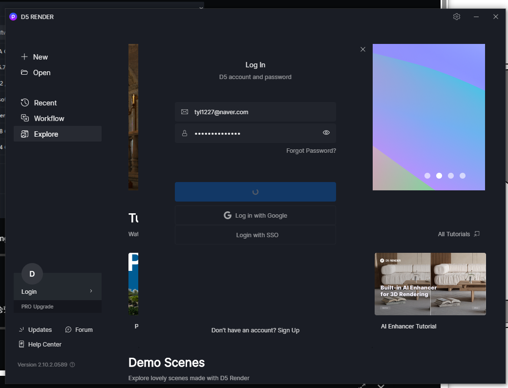

I can’t log in after installation. I can log in from another laptop, but the screen won’t go over even after trying with multiple accounts.

I tried it again today, but it’s still not logging in. When I used it a year ago, it logged in without any problems.
Compared to people who are having similar problems with me, I suspect network issues, but I’m using it easily on other websites without network issues.

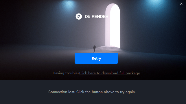

And I don’t know if it’s a related issue, but I had a connection error when I downloaded the file. So I downloaded it to the file shown in the image and installed it.

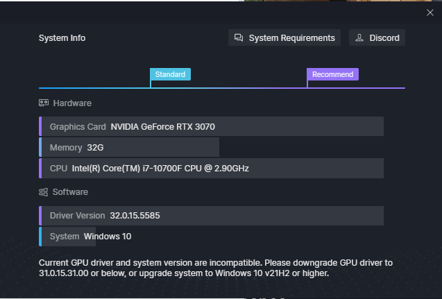

Hello, weirdly I was trying to collect logs as you said but I don’t have that button on my screen…
화면 캡처 2025-06-12 005956
Hi @tyl1227
That’s certainly odd, but it’s best to follow the Prompt note that suggests you either:
  • Update your GPU Drivers
  • Or update your Windows Version
After updating, you can reinstall D5 Render and see if the you are now able to log-in, otherwise you can try to generate the log files then send it to me.
Hi, I tried to create a log file as another administrator told me, but in the image I posted right up there is no log creation button.
First of all, I am updating the window.
I solved it!!!
I did a Windows update as you said. The program has since been successfully installed, and the login has now been successfully completed.
