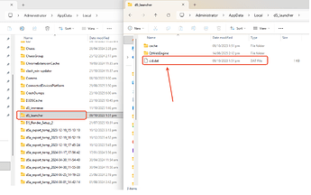

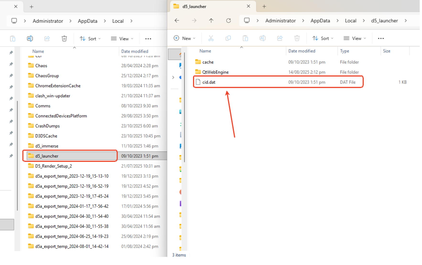

This issue is usually caused by a mismatch between the CID file and the local and Windows registries. Please try to do the following:
  • Open Windows Explorer and enter: %localappdata%\d5_launcher
  • Locate and delete the file: cid.dat
  • Restart D5 Render and try again.
