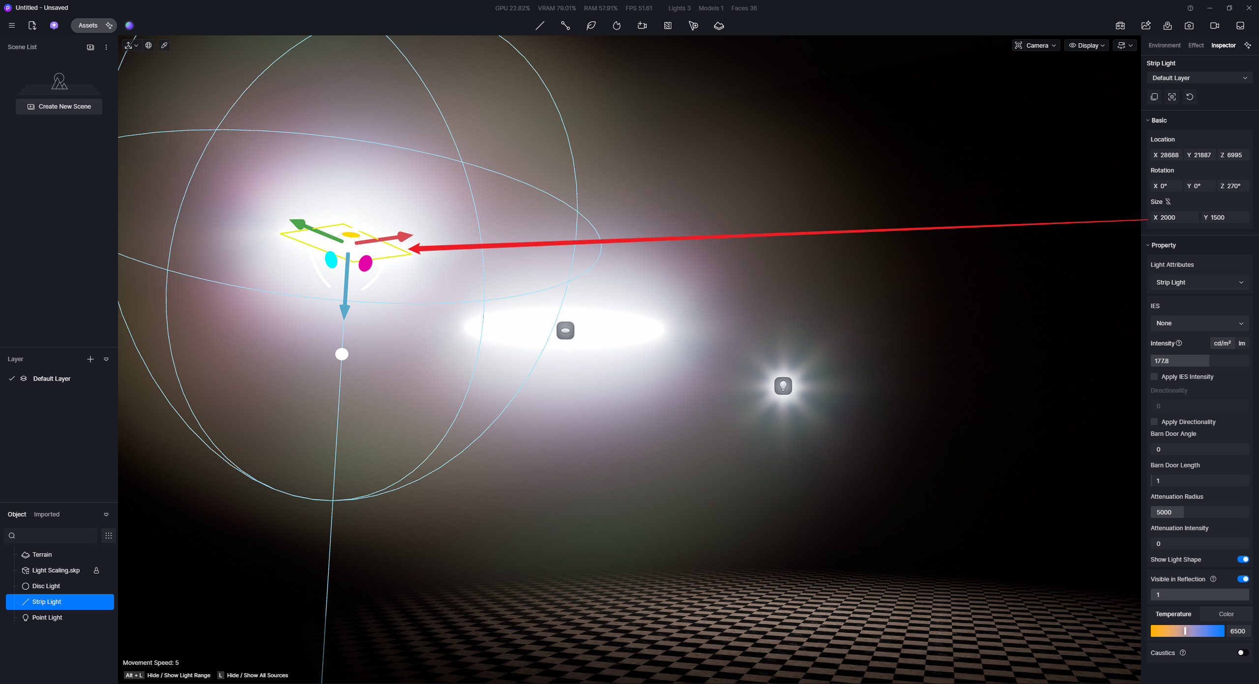

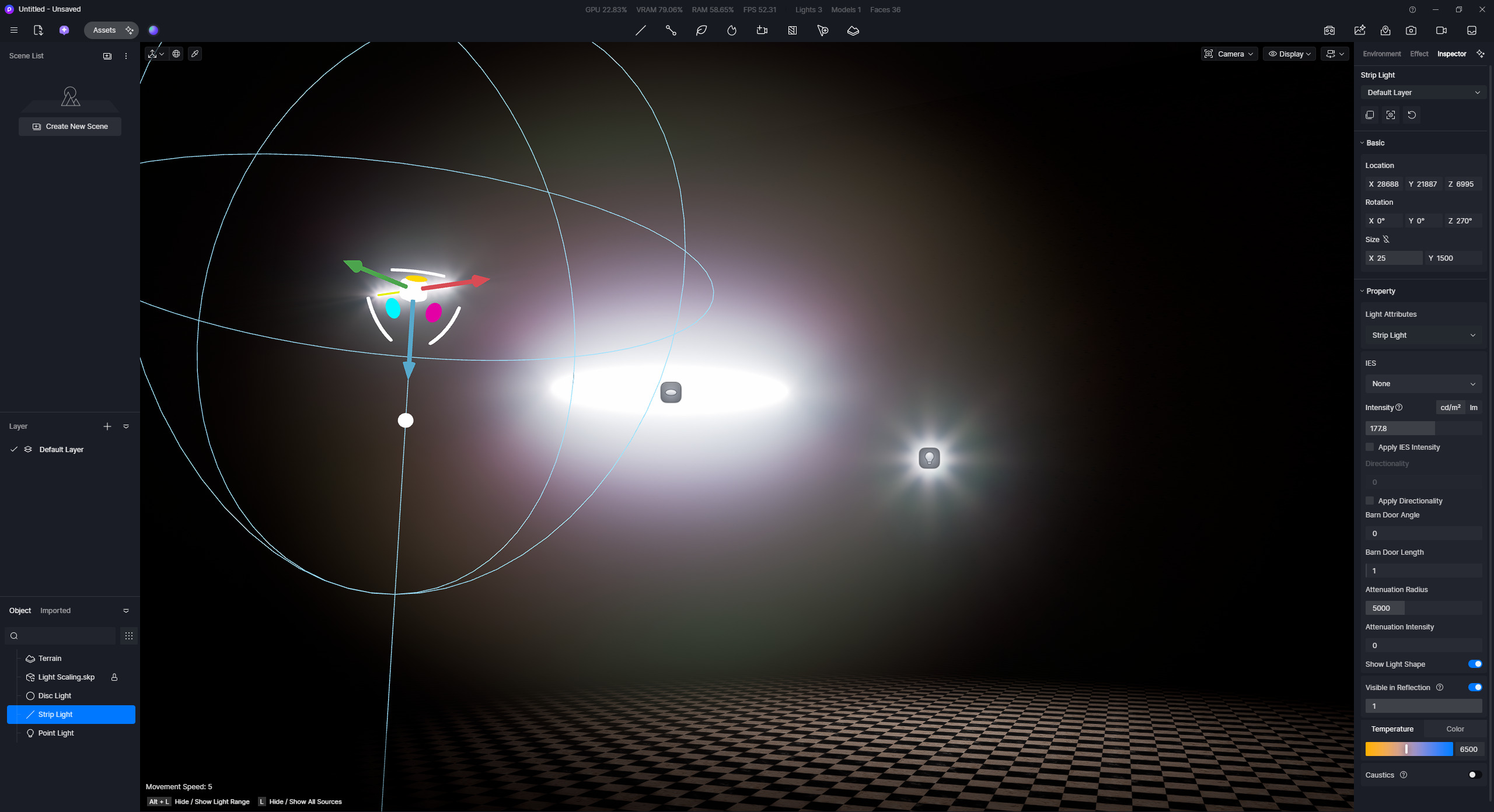

Issue Description: When scaling a light (any light type) above aprox. 25 meters, the light shape scales, but the light intensity doesn’t scale above that.
Steps to Reproduce (optional): Create large indoor area (50m wide x 20m tall, for example), add a light source and scale it above 25m. Light doesn’t expand above that.

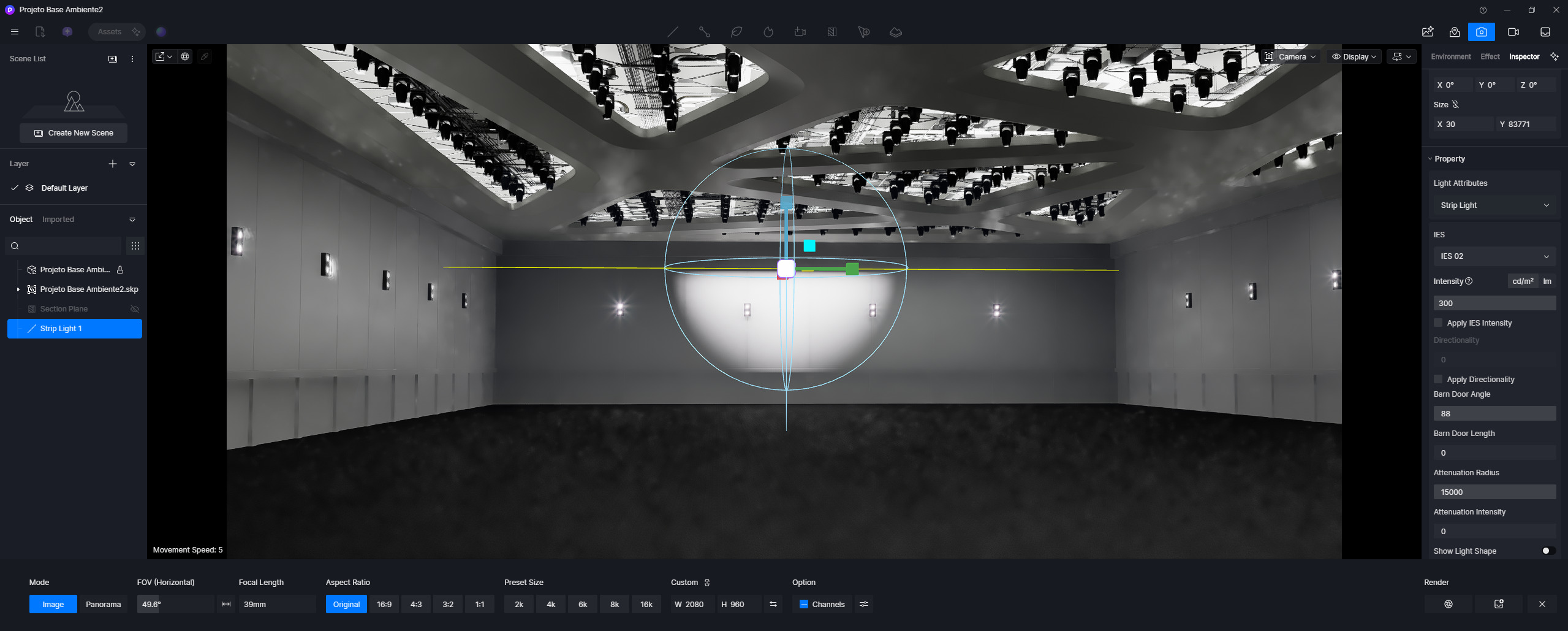

As you can see in the video, at some point, the light stops growing. So i have to create a lot of lights to achieve the effect i want. These files i’m testing are all made in Sketchup 2026 btw.
Hi @pintas
Try increasing the attenuation radius beyond 15,000; you can enter the number directly instead of adjusting the slider.
Thank you! For whatever reason, i thought 15000 was the maximum :slight_smile:
