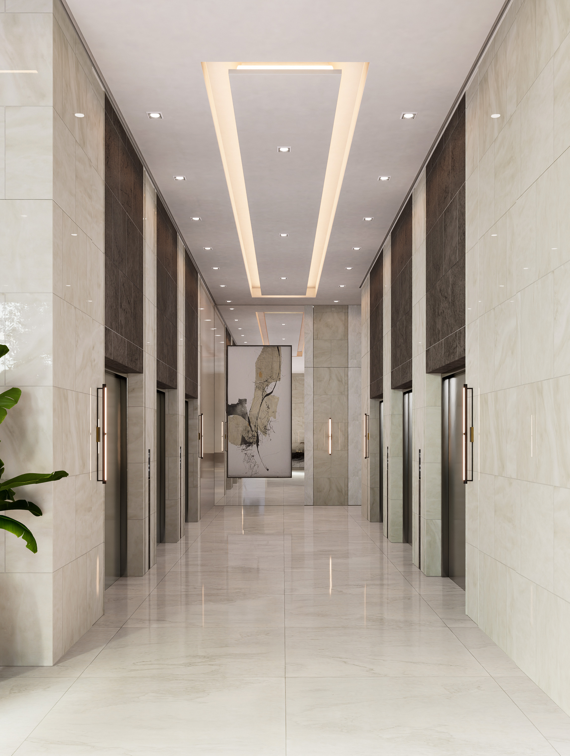

I Have the same problem in various models/scenes!
img 04|690x388
