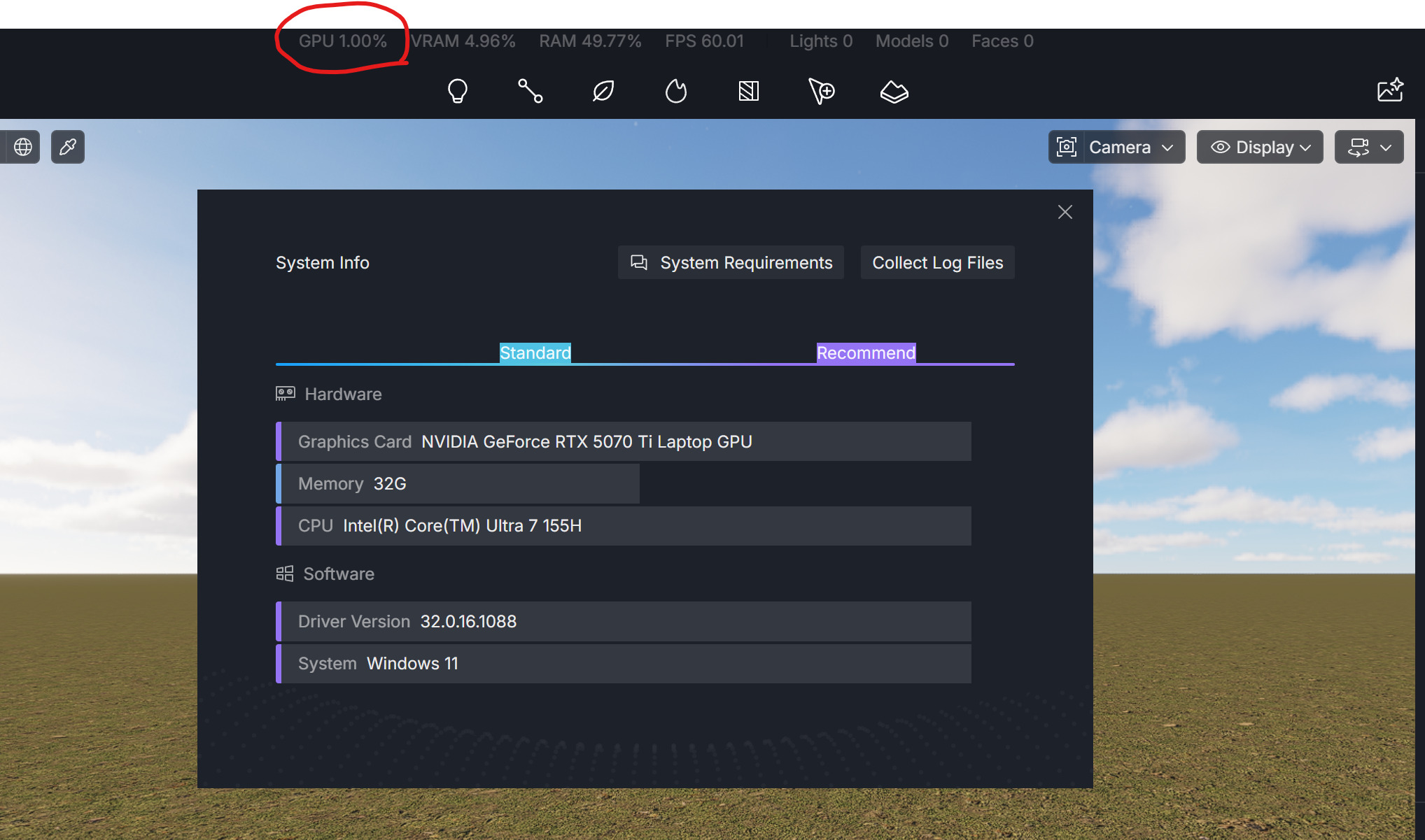

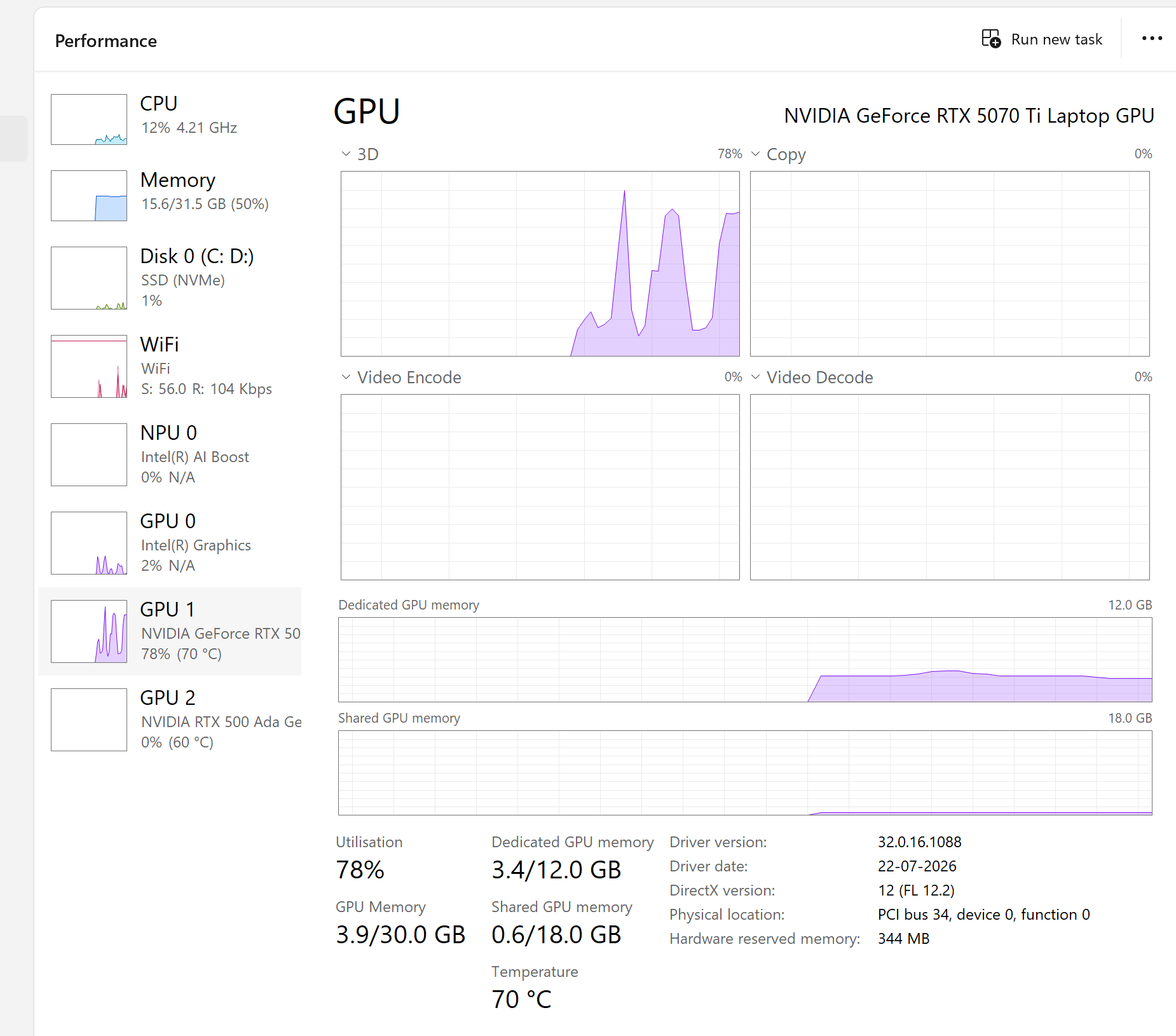

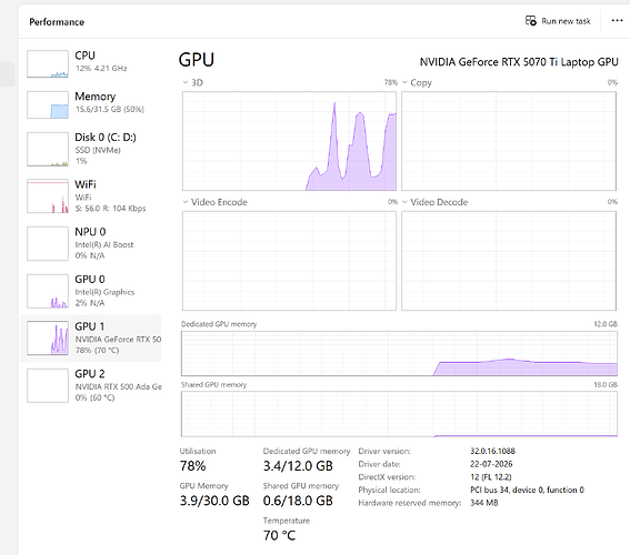

**Issue Description: I have a lennovo P14s laptop with Nvidia RTX 500 ada as inbuilt gpu. D5 works fine and on the top of D5 statics GPU shows reading correctly about GPU usage. D5 runs fine. When I connect my egpu, D5 recognised 5070ti correctly but in D5 top stats shows 0.0% and it stutters every 2second. I can see in task mnager its using the gpu but for some reason its not updating gpu stats and stuttering in D5.
It can be seen its using the gpu but the gpu bar shows 0.0 in stats. and its stuttering every 2 second while orbiing.

Hi @Clov . Thanks for the reply. I finally figured out the issue with the help of Chatgpt.
Anyone who is seeking help on this just disable the Discrete GPU inside device manager and keep EGPU and Intel graphics enabled. Restart pc with egpu intact (Check in device manger Discrete Gpu still disabled). Everything runs fine then !
