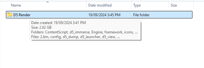

Hello again
I would like to share an important observation: when downloading the new version of the program on my new computer, I noticed that the installation process happens very quickly, as if the program is incomplete during installation. Even though I’ve downloaded the program multiple times from the official D5 website, the same issue persists each time.
Could this fast installation or missing files be the cause of the problem I’m experiencing? I would appreciate your guidance on how to check this or reinstall the program completely.
Thank you for your attention and continued support.
Best regards

Hello,
You can try to do a complete re-installation of D5.
Enter ‘’%appdata%‘’ on your PC to find those folders with the d5 prefix on C drive. Delete them and then reinstall D5.
Hope it could help.
Hello again
I would like to clarify that I attempted to reinstall the program using the suggested method by deleting the folders from %appdata%. Additionally, I used Revo Uninstaller to completely remove the program, but unfortunately, the issue persists.

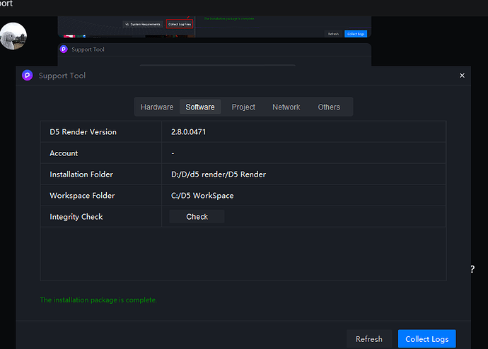

Hello Leah_Li
I have already checked the installation completeness and made sure that my Windows profile name is in pure English, but unfortunately, this didn’t resolve the issue. I hope you have another solution, as I am starting to lose the ability to continue working with this program due to the ongoing problem.
