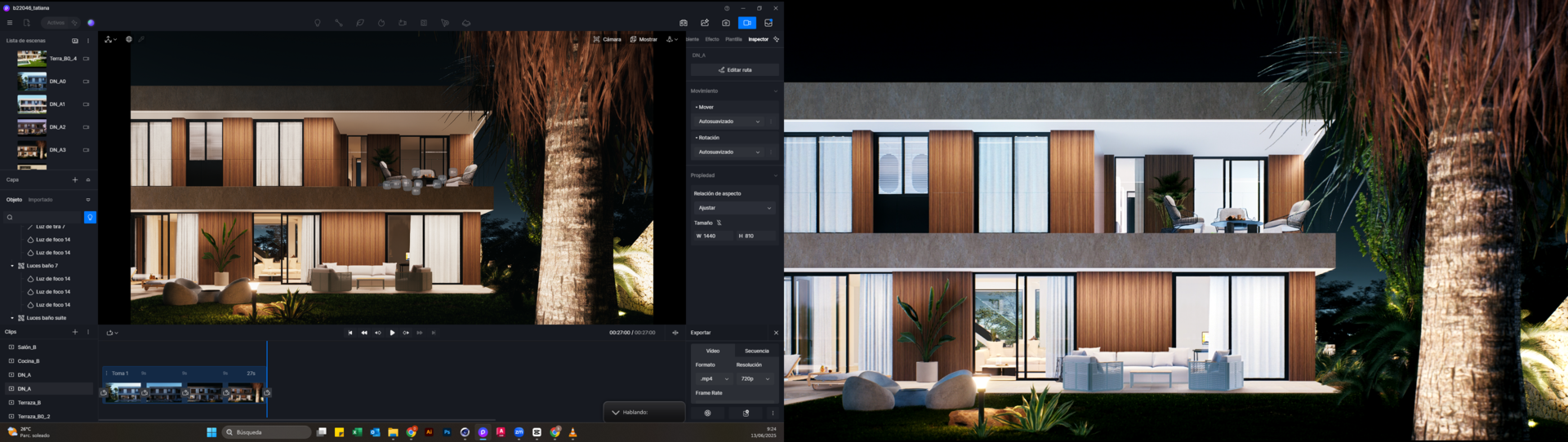

Hello,
I’m encountering an issue in D5 Render where the final output appears significantly overexposed compared to the real-time preview. In the attached image, the left side shows the preview, which looks balanced and natural. The right side shows the exact same frame after rendering — with blown-out lighting and a strong white cast on the interior and curtains.
This occurs during a day-to-night animation sequence, mostly at dusk. I’ve already checked camera exposure, emissive materials, and lighting setup, but the problem persists.

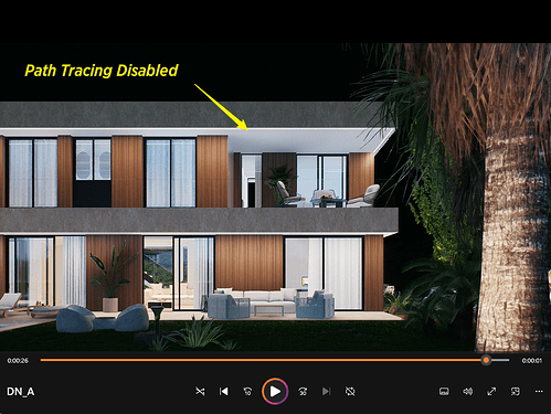

Hi @david2

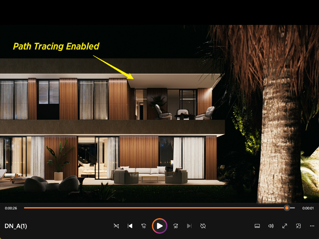

I just tested your file. Enabling Path Tracing will significantly improve the final output. Generally, path tracing is more physically accurate than traditional ray tracing.
Hi Clov!
Thank you very much for your support and for taking the time to test my file in detail.
I sincerely apologize. The issue was not a bug in D5 Render, but simply a result of my own inexperience. I didn’t realize that Path Tracing needed to be properly enabled in order to achieve the correct lighting in the final render.
Now that I’ve activated it correctly, the results are exactly as expected.
I really appreciate your guidance and your patience, it has been very helpful to understand how D5 Render works more deeply.
