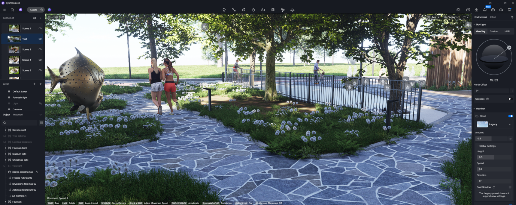

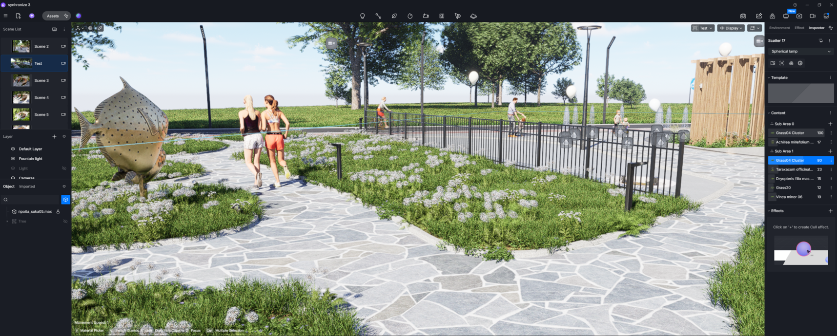

I’m trying to scatter grass, and there’s one thing that bothers me. I’m using D5 together with 3ds Max.
So, in the scene, I have two objects from 3ds Max: the main scene itself and the trees, which I imported into D5 as a separate object.
I don’t understand why, when I scatter the vegetation with the imported “Trees” object turned off, the grass covers the entire lawn area. But when I turn “Trees” on, the grass stops growing underneath them, leaving a large bald patch!
When the trees are not present or are turned off, everything works fine.
Is there any way to control this behavior?

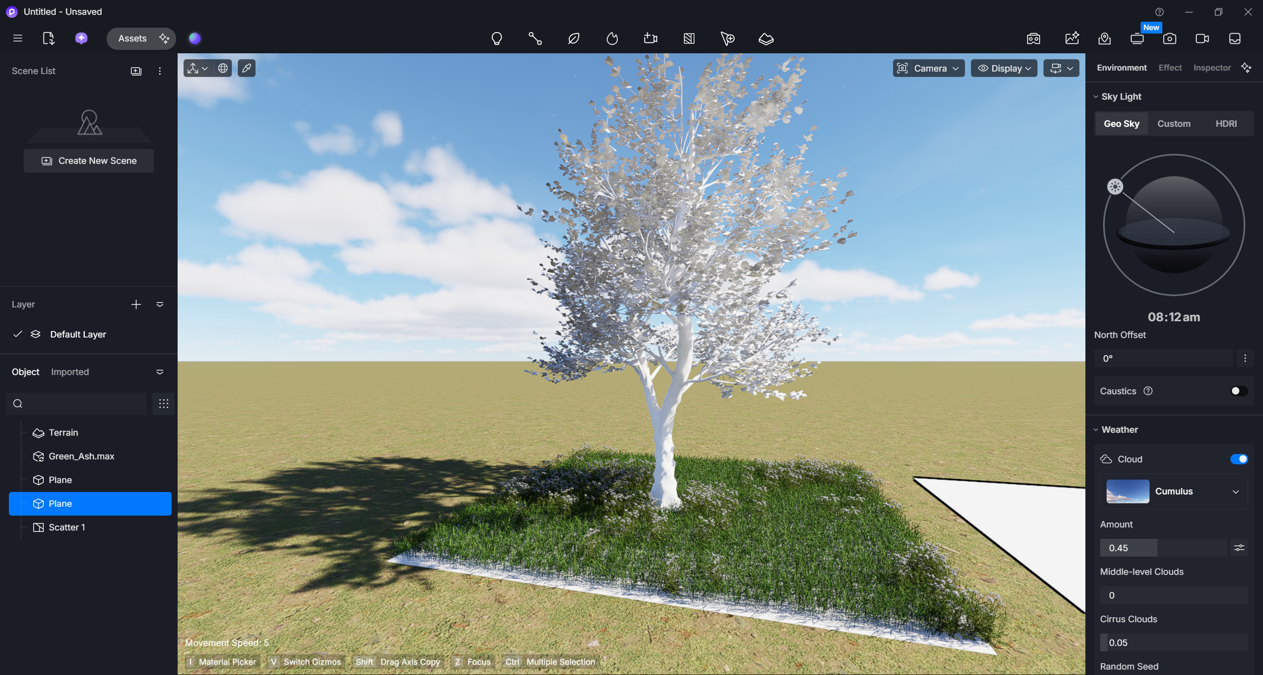

Hi @dessirio
I imported a tree from 3ds Max and used the Scatter tool, but it doesn’t seem to produce the same results.
  • Can you please send us your D5 File and the vegetation model so we can also check it on our end?
