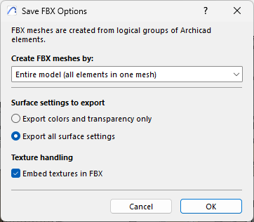

  • I’m using AC 28, I exported the AC Model (Save As > FBX Model), before proceeding, a window prompt appeared, and these are the boxes that I checked.

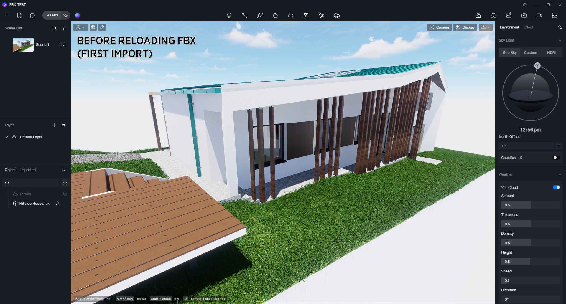

  • I proceeded to import it in D5 Render and changed some materials from the D5 Library
  • After that, I modified the AC28 Model by deleting the Wood Slats, then exporting it in the same manner and on the same exact file name of the first FBX file (basically, I just replaced the first FBX file with this one).

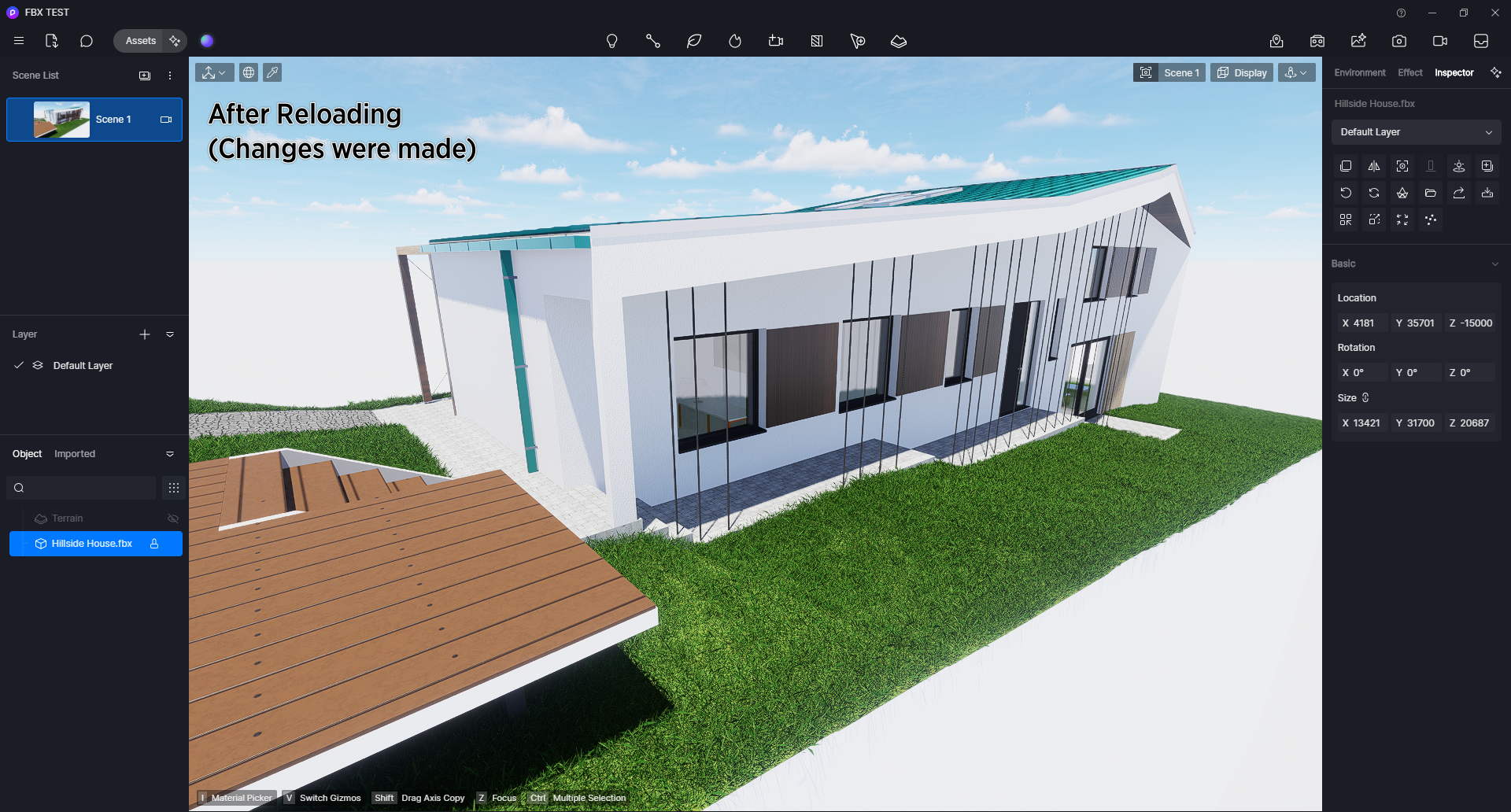

  • I select the model in D5 first, then reload it by clicking the “Reload Button”
  • After reloading, the materials have been retained, and the model has been successfully updated.
