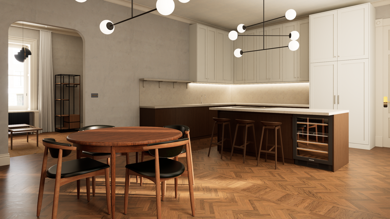

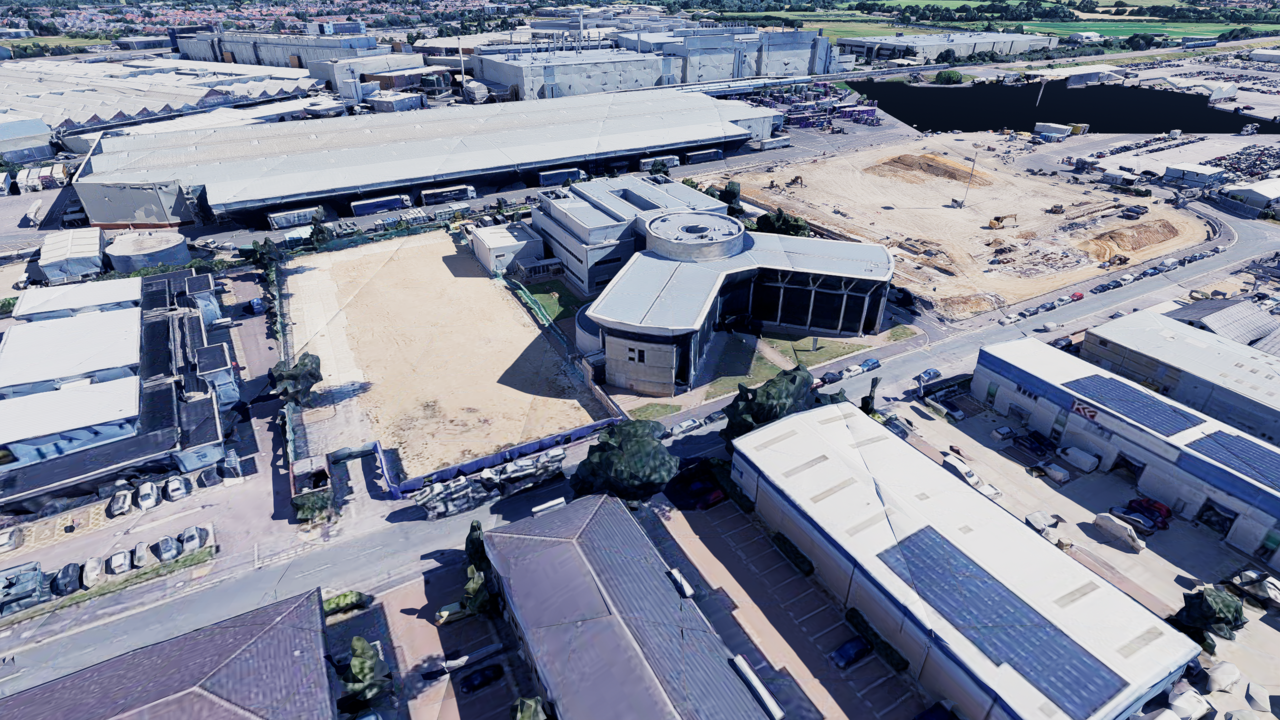

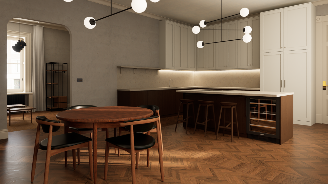

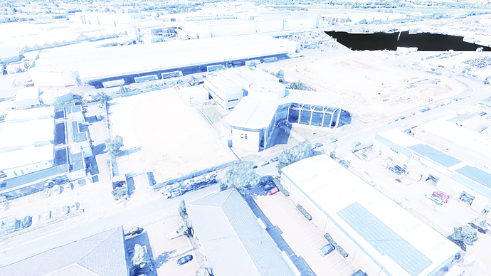

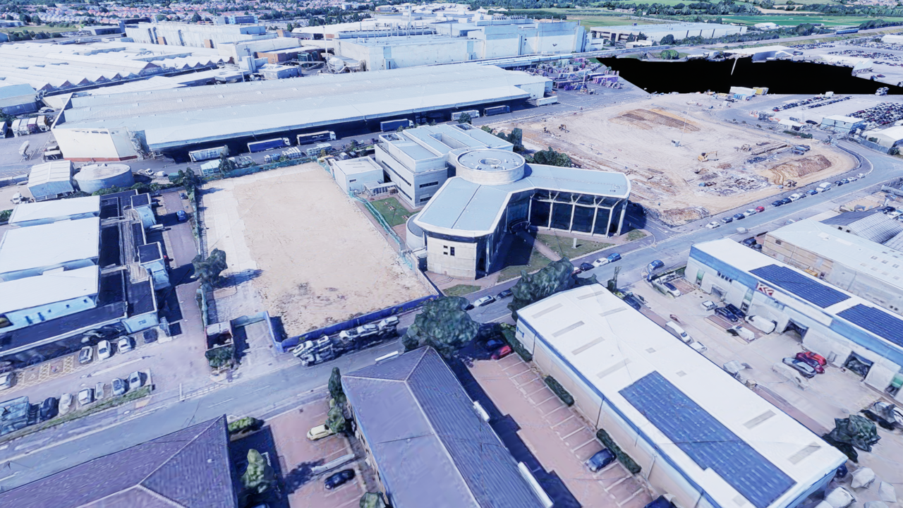

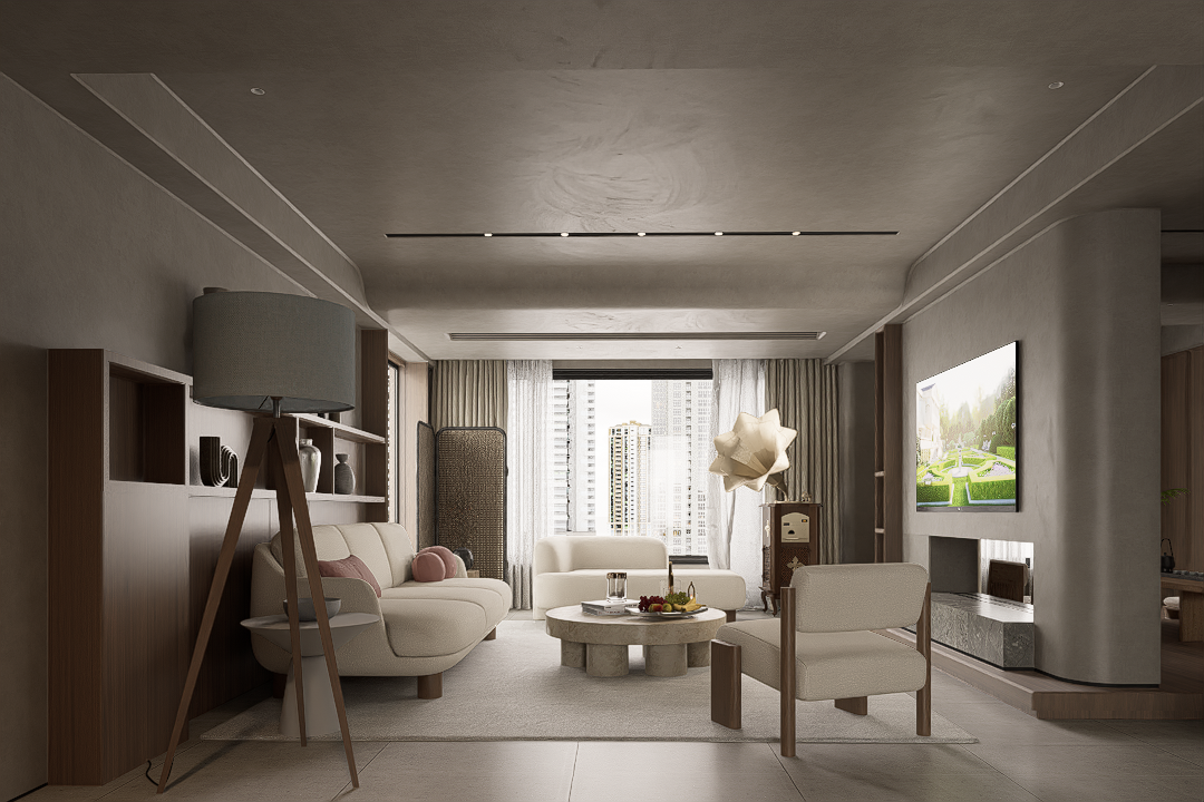

Hi Anthony, no problem.
To explain further. The issue for me occurs if I have the Environment set to Custom or HDRI. In this mode, the output is clearly different if you render in Smooth/Precise, as you can see in the examples, especially in the HDRI where it blows out. On Geo Sky it’s perfect with no issues as you’d expect.
Let me know what you think
Also just to note, there is some weird clipping in Cesium that you can see with the dark patches, no idea why this is happening, only just happend today!
