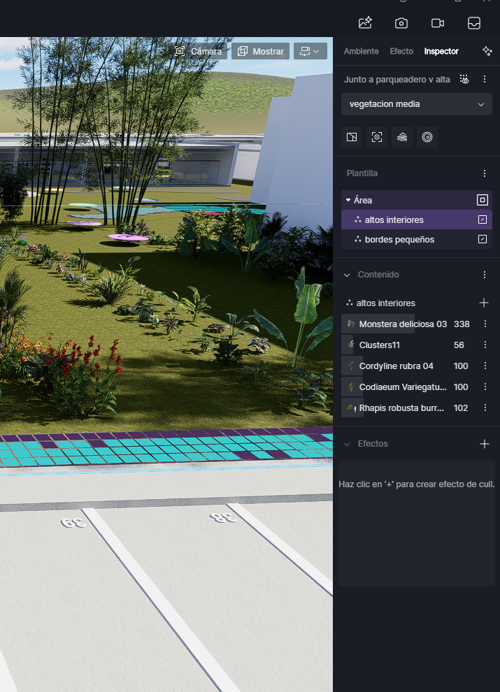

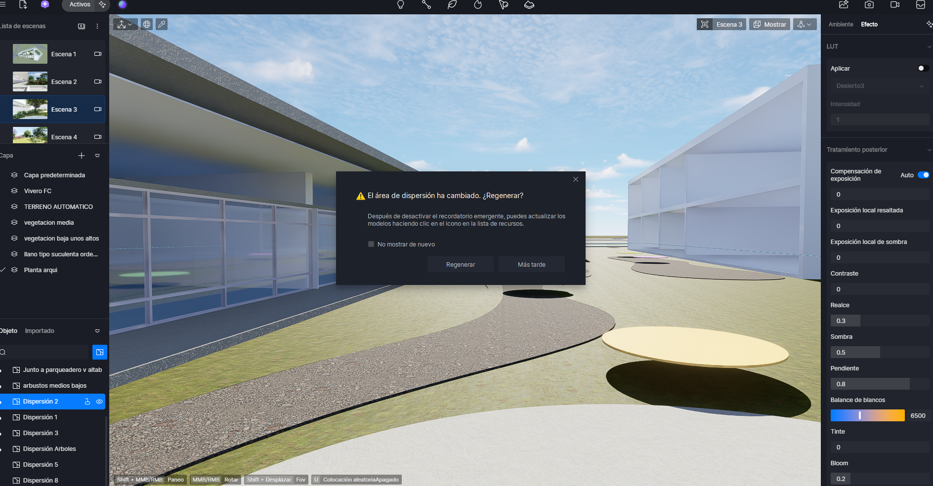

  1. I create a scatter on a surface.
  2. Initially, the scattered models appear correctly.
  3. After regenerating or reopening the file, the scattered models disappear.
  4. Only the green grid boxes remain on the surface, but the Inspector panel shows nothing (it is completely empty).
  5. I have tried reassigning models and creating new scatters, but some of them become corrupted and cannot be edited at all.
