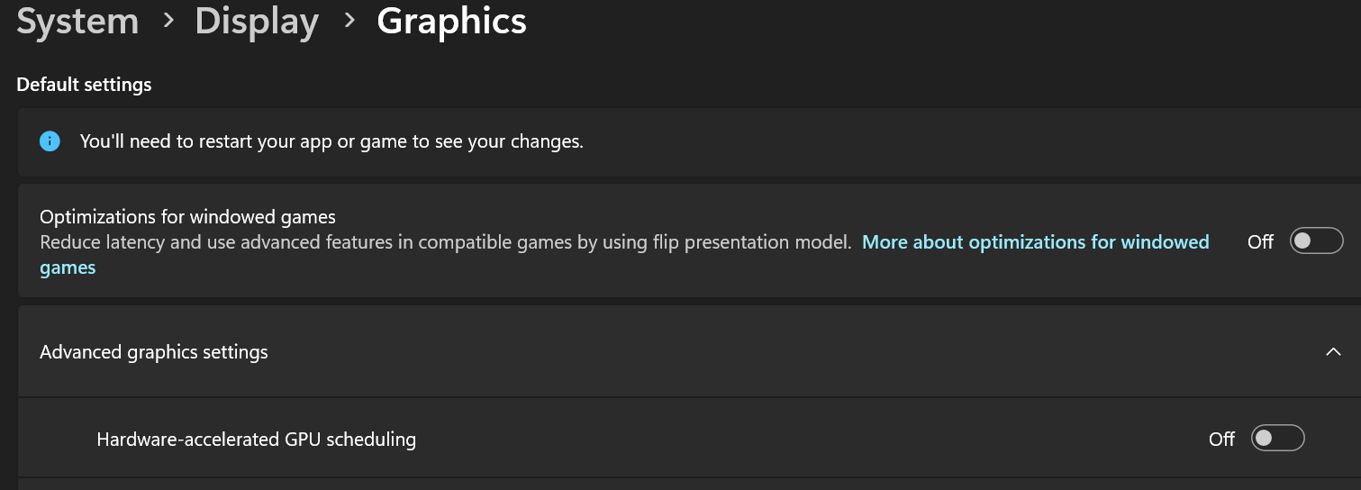

- Disable GPU Overclocking
- Disable Hardware-accelerated GPU Scheduling
