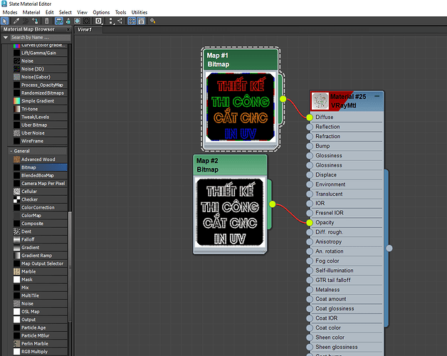

**D5 Render Version:2.8
**Graphics Card:rtx3070
Driver Version:
Issue Description:
Hello @saovangshop
Thanks for reaching out.
Are you referring to the âmultimedia material templateâ in D5 Render?
You can refer to this post for more details:
How to use the Multimedia Material? | User Manual (d5render.com)
If I misunderstood, please let me know.
Alright, you want to create the hollow effect in D5, right?
You could try the âCustom Alphaâ material template.
Please refer to:
What materials are the Custom Alpha templates suitable for? What are the special parameters? | User Manual (d5render.com)
it doesnât work with video
