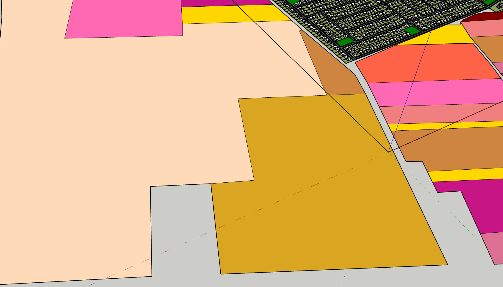

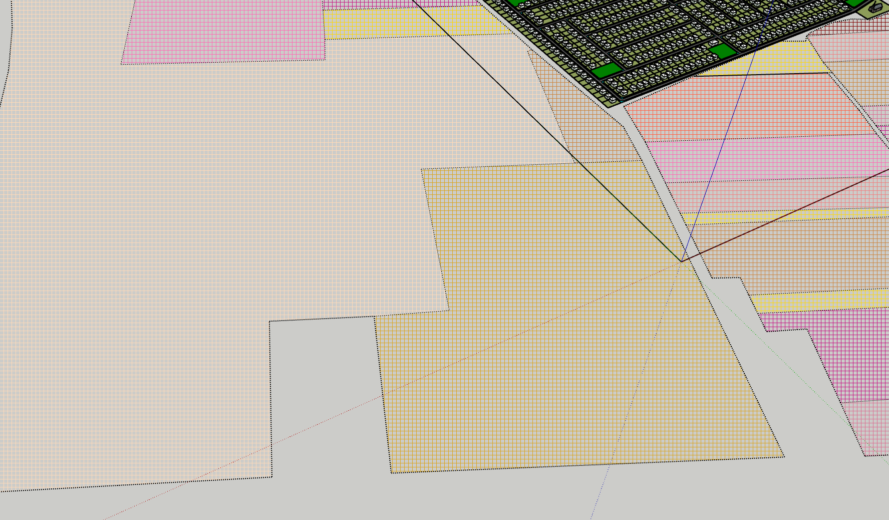

As you can see in the first image, when I select the area where I used the “Scatter tool” by material, I get the following error: “Cannot be parameterized now. Please edit scattering surface to activate it.”
The entire process went as follows: In SketchUp, I grouped all the crop areas with different colors. They are part of the same main model, which is linked with D5 Render. I applied scatter everywhere, and then in D5, it worked perfectly. I then hid the group with the objects from which D5 Render had applied Scatter in SketchUp because I had another object in the background (as seen in the first image from Google Maps), and I needed Google Maps to be visible underneath while Scatter was displayed above.
Everything worked perfectly, and I could disable the crops generated in D5 Render to improve my computer’s performance, as there are quite a few generated areas. The problem arose the next day when I reopened the project and tried to hide the scatter crops in certain areas. I managed to hide them, but the issue was that I could no longer reactivate them. The error mentioned at the beginning persisted.
I repeated the process of adding all the Scatter crops at once, and the same issue occurred the next day. Could this be because I hide the material in SketchUp and D5 “forgets” the Scatter position? I don’t delete them—they’re still there—but even if I unhide them, the error persists in D5.
I’m hesitant to test further because of a project deadline. For now, I’m leaving everything active as it is in the first image, sacrificing a faster workflow.
I hope this detailed explanation helps. Have a great day, and I hope you can solve the issue!
Hi there, thank you so much for your detailed steps. I could also replicate the issue by hiding the object or surface (in SKP) where the scatter was applied in D5, and then the error prompt occurred. I will be forwarding this to my team, thank you again.
