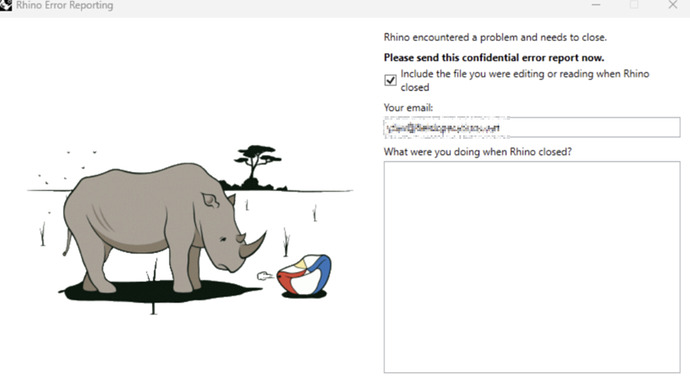

Same issue here. Also got the Rhino Error Report.
