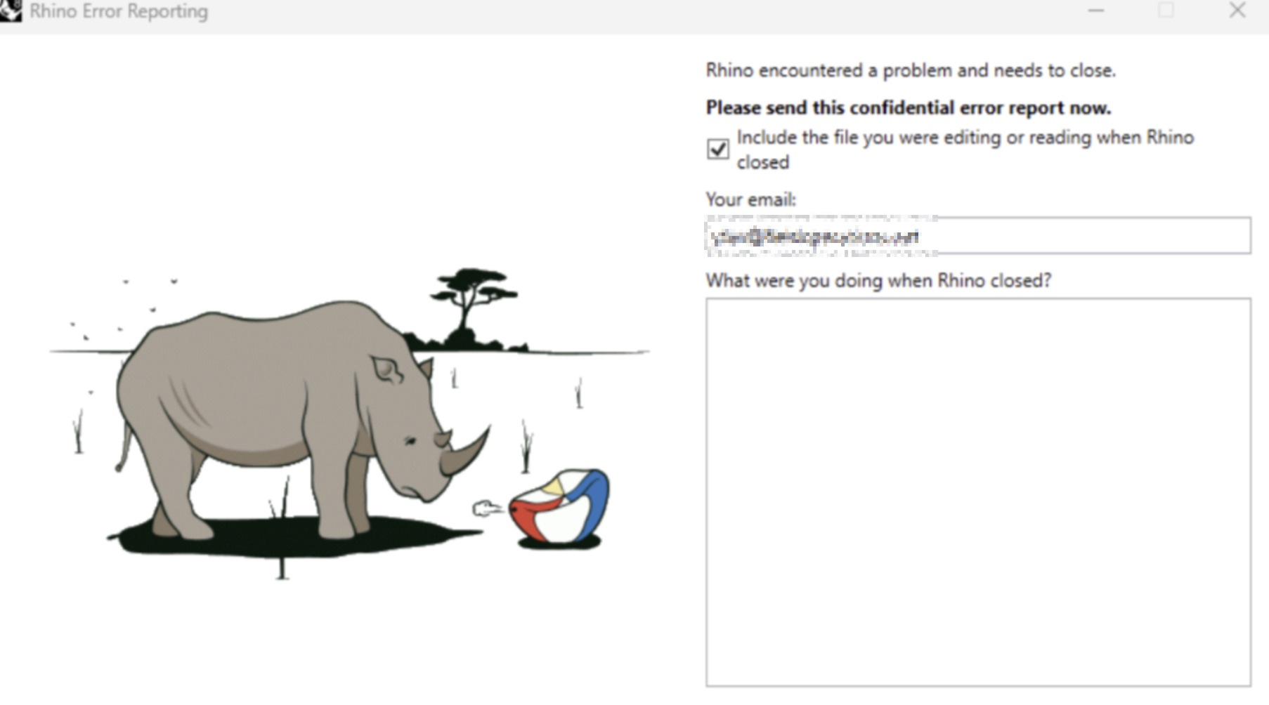

This morning upon launching the D5 launching I was prompted to upgrade to the newest version. I did and when I wanted to connect my existing file to D5 (same rhino and D( files I had been using last week) rhino instantly crashed .
I updated D5 and rhino to their latest versions and the crash still happened . I tried to sync an empty rhino file (with just a cube in it) with the same D5 file and it worked . So it seems the problem is with the existing rhino file or because it is too large . However the previous version of livesync didnùt have that problem .
Is there a way to download previous versions of livesync ? specifically the 1.1.0 version . All I have is the “D5_Live_Sync_Rhino_usa_latest” which only installs the latest version . I donùt have time to try and rework the file altogether .

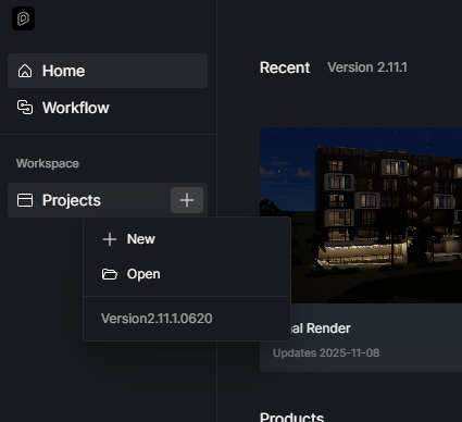

I’m experiencing a crash issue with the Rhino Live Sync feature in D5 Render.
D5 Render crashes whenever I use Live Sync mode and make real-time changes to my Rhino model. The only workaround I’ve found is to disable Live Sync and manually use “Sync Once” each time I need to update the model.
Version Information: Please see the attached screenshot for version details.
I would just like to clarify if this issue occurs with all of your files, regardless of whether it being too heavy or too small? Does it also occur in completely empty files?

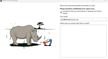

Hi Clov, I am having the same issue that Eli was having, but I have the latest version of Live Sync. As soon as I start the Live Sync from Rhino 8, Rhino crashes. It does not do it all the time, but for some reason it keeps on doing it to me right now. I will attach the version I am using.
Hey, I will send you a previous version (at least it is a previous one for me), and try that. I guess the current is 1.1.0.0005, but I have a 1.1.0.0002 download in my files. It seems to work for me so far. It says “latest version”, but that’s just from when it was the actual latest. Hope this helps
Sorry for the inconvenience. Please collect your dump files from version 0009, upload the zipped folder to WeTransfer and send me the link privately. You can find the guide in my post above. Thank you.
