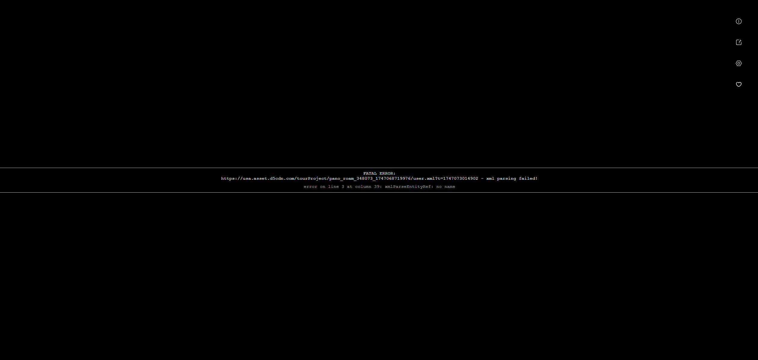

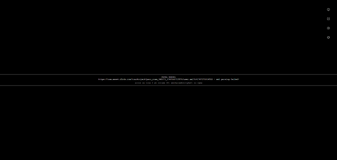

I just regenerate the Virtual Tour but give me this problem recently. I cant use the VT nor see the images.
