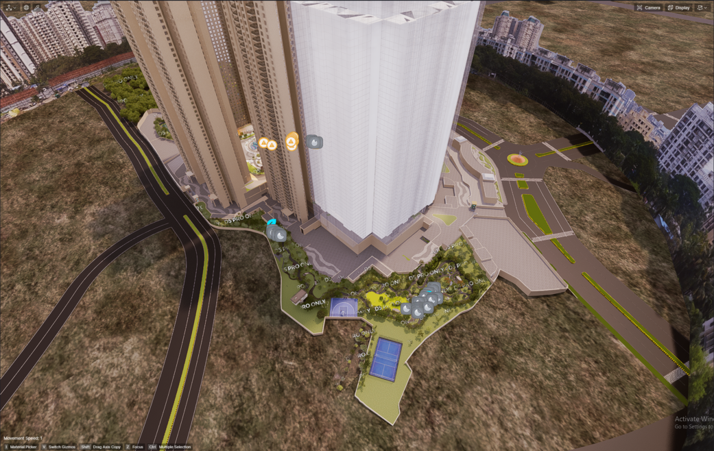

Issue 1 : Whenever I try to use HDRI the sky portion turns completely black, even though the light intensity does change with the setting, but the sky remains black.

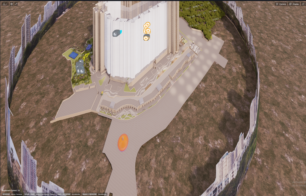

Issue 2: When i have added the model to the roads in local & synced it, but the roads do not show up, the files are visible in the imports section, only the model is not visible.
**Screenshots/Videos Description: Sharing the link to the file - https://drive.google.com/file/d/1GBECR-wPRNmPQlgY9tqc7THMFkE9jDpI/view?usp=sharing

2 - As for the roads, are you using D5 Terrain? Try disabling it; perhaps it is being blocked by the terrain. Also, just to be sure, after importing it, you did place the model by right-clicking it and selecting “place”?

  1. Yes the z axis is a whole number. I even tried changing it, there is no change.
  2. As for the road, i synced the whole model, it was there earlier, but suddenly roads didn’t show up. The file is visible.
