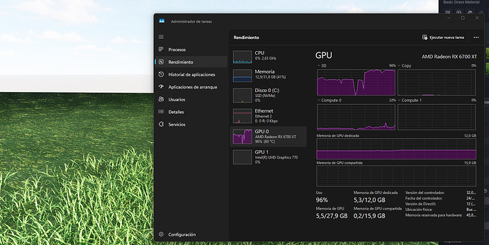

Issue Description: Since updating to version 2.11, I am experiencing a critical issue when applying the Grass material. Even in an empty scene with a single small surface, as soon as I apply the Grass material, my CPU usage spikes to 100% and the system temperature rises rapidly (close to 100 °C) until D5 crashes.

Thank you very much for the response, but this is not a rendering issue — it happens during modeling. As you mentioned, my RX 6700 XT is powerful enough and can even handle large renders in D5 without any problems. The issue only occurs when I zoom in on a surface with the Grass material applied, and it is the CPU that overheats by going up to 100% (while the integrated graphics remain at 0%). On the other hand, the GPU shows no VRAM issues.

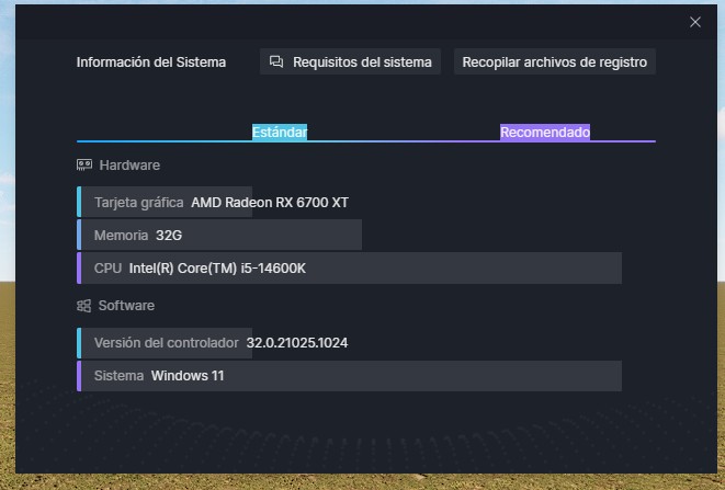

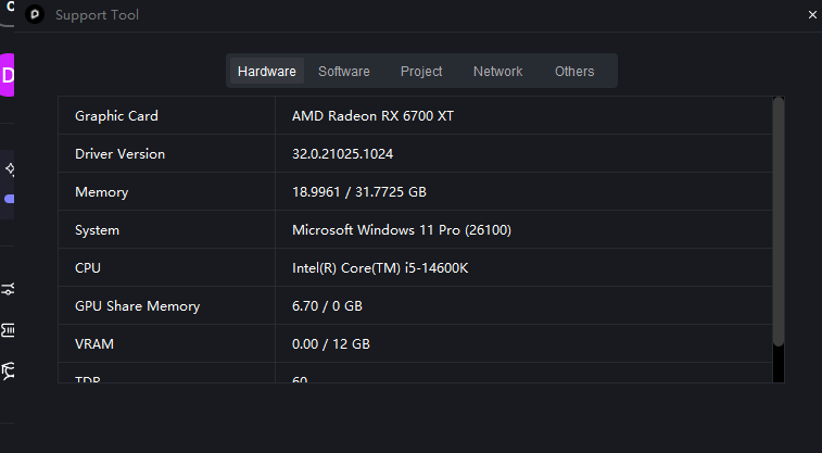

I’m attaching the requested information.

the vram is not the problem, as you can see its not full
