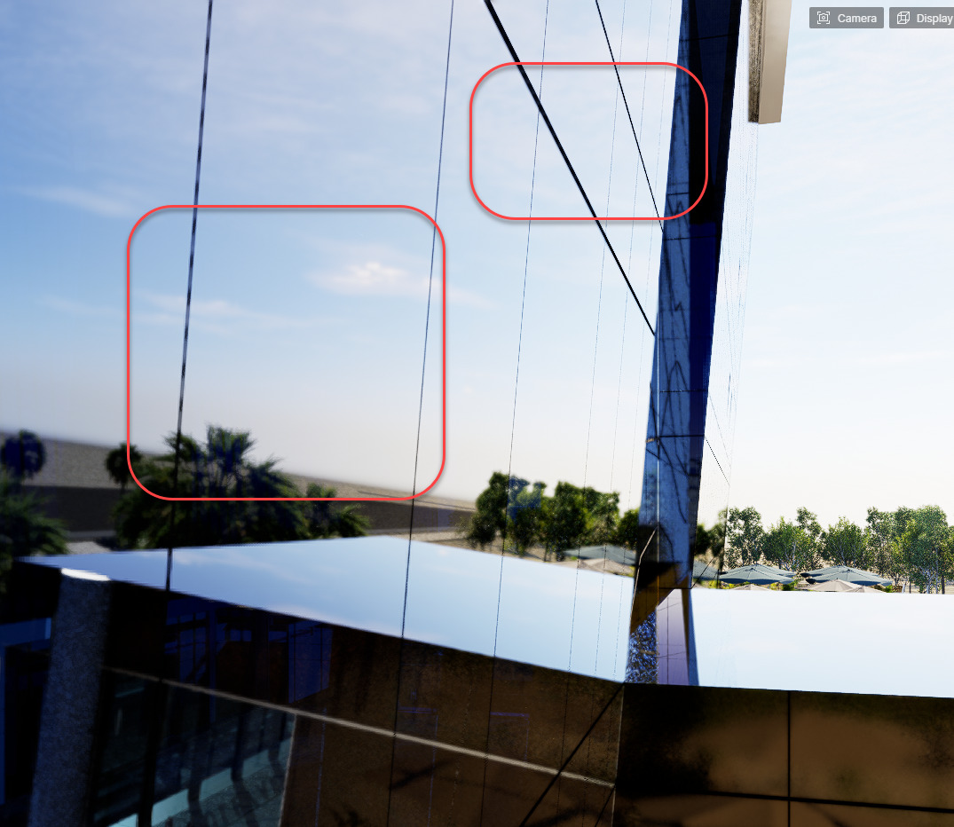

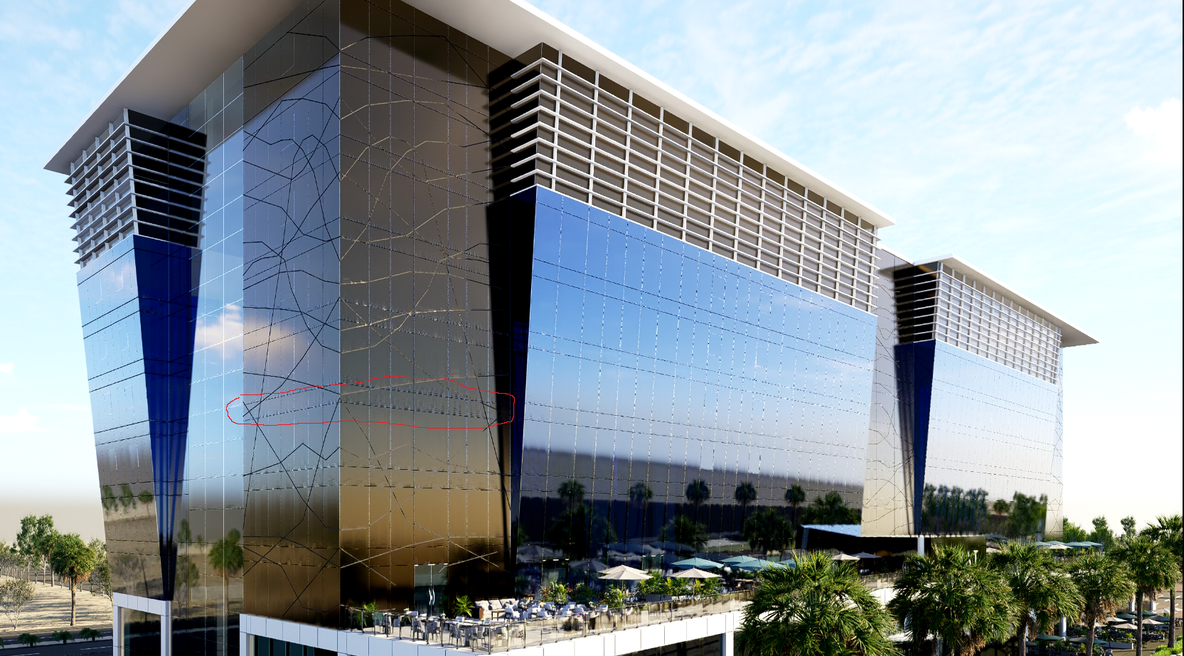

HI i need help i’m rendering animation of my project but the Glass flickering too much…

Hi Thanks for you reply sir, i attached here animation renders link please check.
i used these all option you mention above. turn on and off but didn’t get any improvement .
https://drive.google.com/drive/folders/1egUUD4XJvMSB9YjdWWHmeQb1ru16S0L0?usp=drive_link

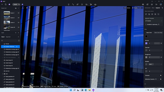

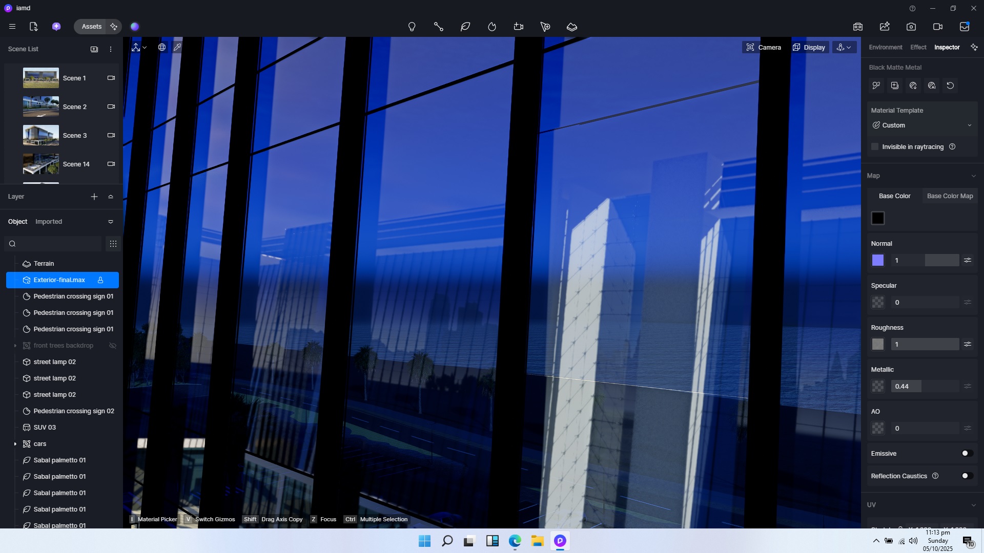

hi, i saw ur videos. imo ur glass is not flickering, its mullion part in joint of glass. try changing material of mullion reflection to lower. its the sky reflection on mullion is flickering.
try black iron material from assets u can lower reflection of same as required.
thanks
Is there any solution sir? Mullions don’t have any reflection i think its glass edges

right, glass edge. i also faced this before in interior scene. what i did, i pulled glass edge inside mullion.
i send you file on this email please check, my project deadline finish client asking for animation please check this asap Thanks.
ok but this issue must be solved because many people facing this issue and this system is curtainwall without cover cup we have to show glass edge’s can’t cover them,

is glaz and mullions are at same level . as i see in view they look at same level or mullions are slight inside of glaz.
yes sir same
can u make mullions slight offset at outside, and check ur end
yes i did in horizontal i moved mullions outside and see the results in animation its 2k 60fps its uploading i will share with you.
