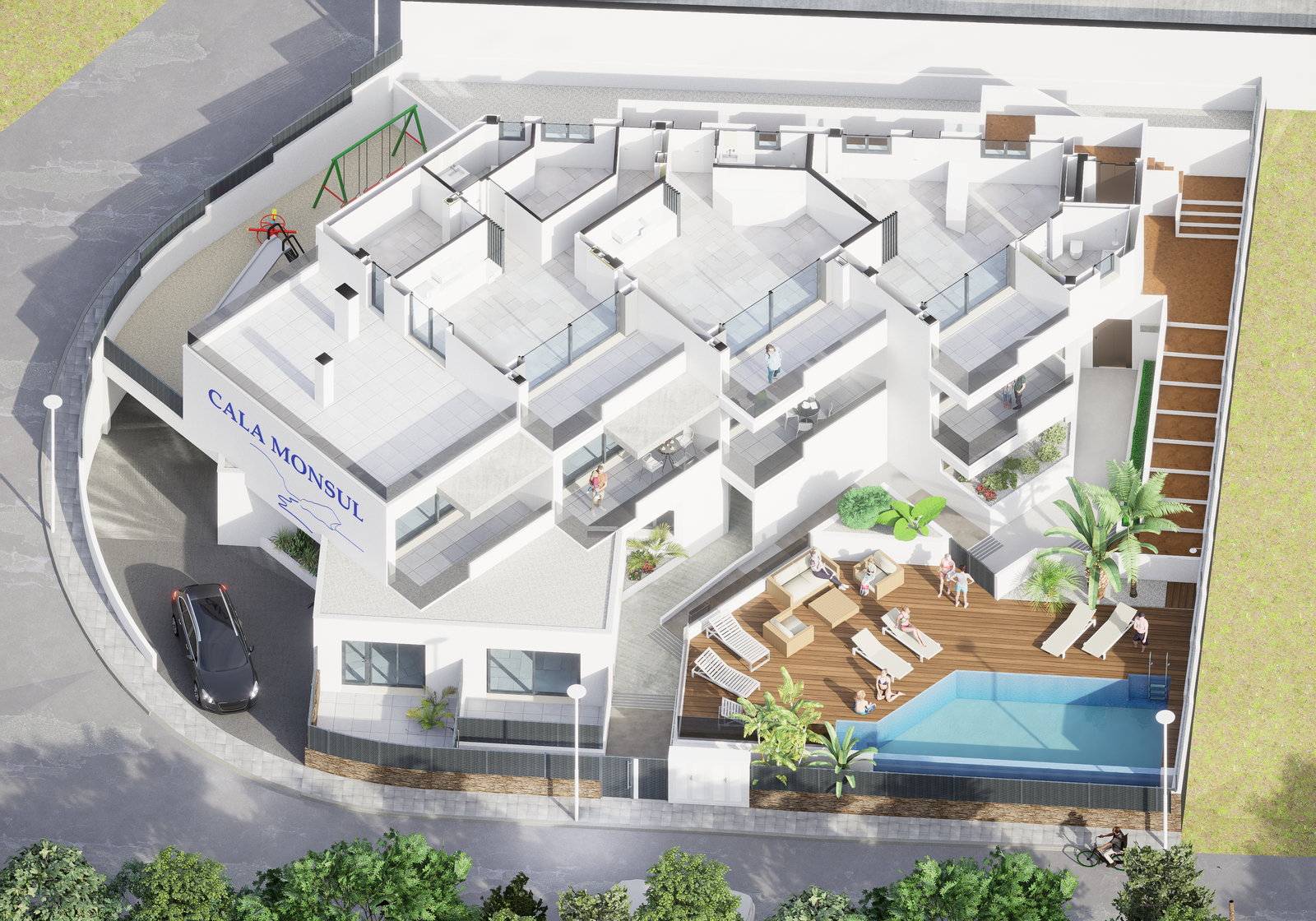

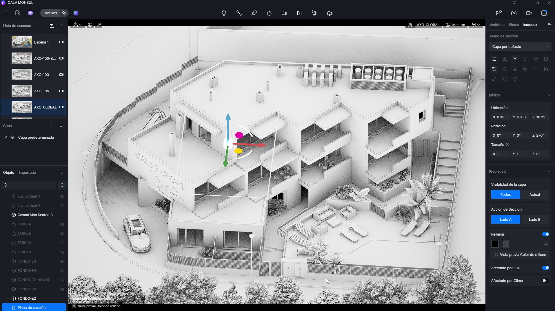

Using an axonometric ambient oclusion style, glas material and other metalic materials do not render. I wonder how this may be acomplished. At the same time I wonder how the filling of the cutting plane thru walls is working, since they are not showing a filled region.
Screenshots/Videos Description: Attaching image files show render output in color and the ambient oclussion version to compare

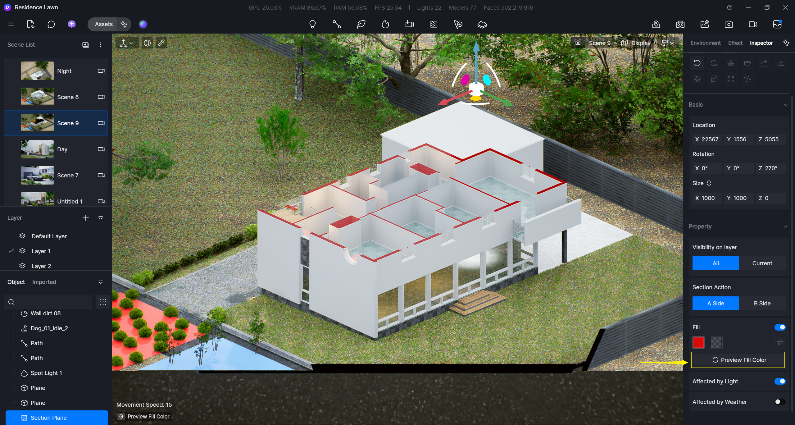

Hi @manyal77
Try changing the color of the fill to red and click preview fill color, the fill color usually shows in the final rendered image.
As for enabling AO and glass/metal material are not being rendered, i may need to confirm if this is under expectation or a known issue.
