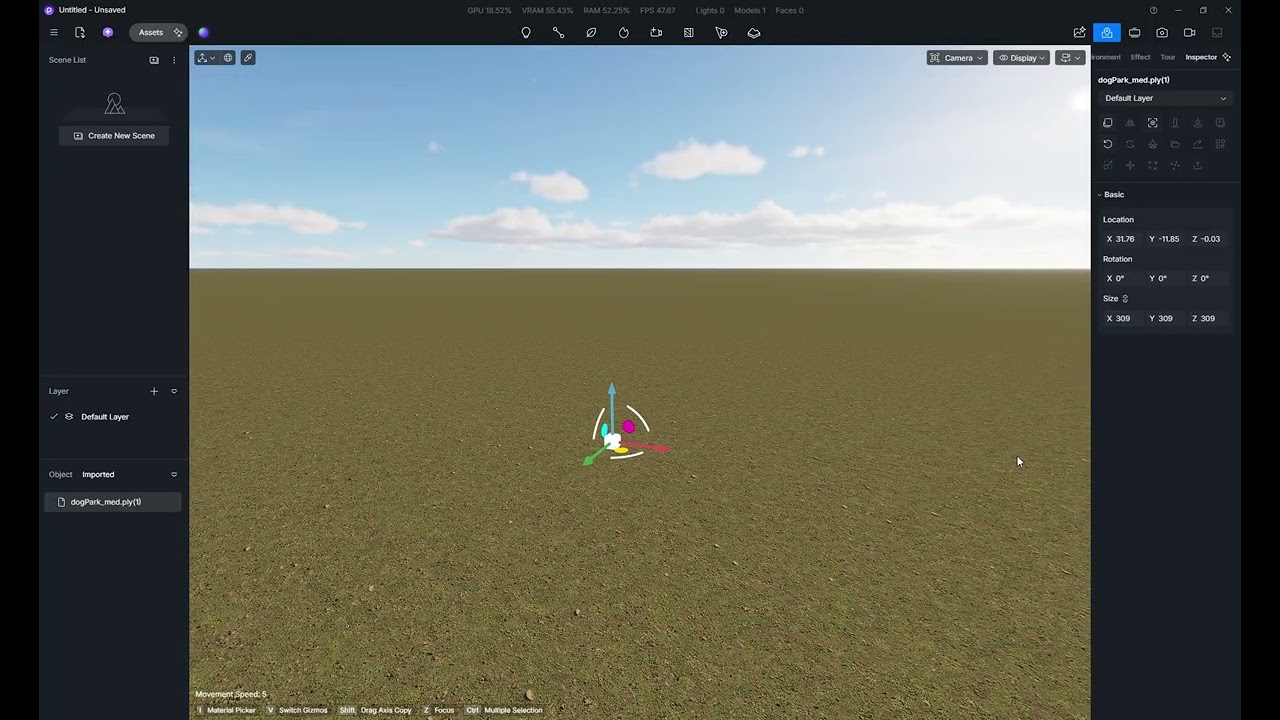

Gaussian Splatting .PLY files import problem - nothing appears in the scene
As the title suggests, I’ve tried importing several different .ply files. However, when I drag them into the scene, all I get is an object icon, and nothing actually appears. The object has zero dimensions.
Why is this happening? I’m working on a large project where I need to import the surrounding environment using Gaussian Splatting. How can I get this to work?

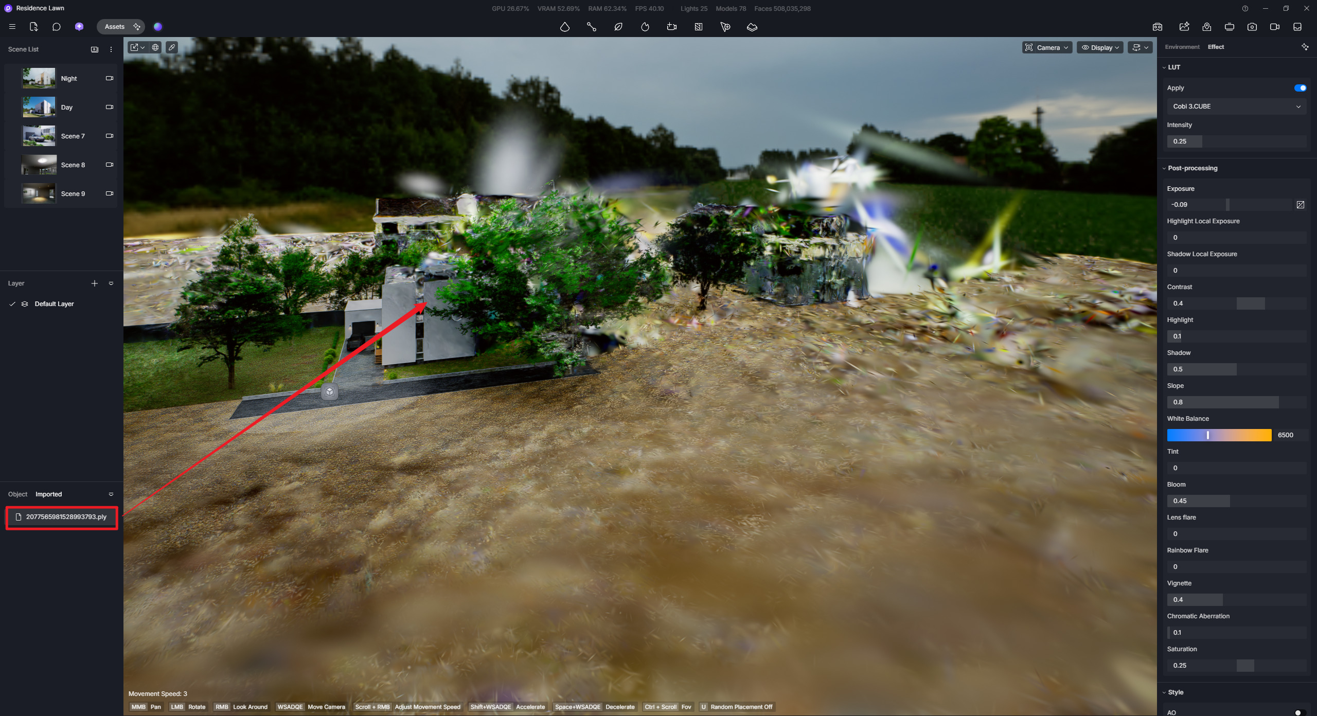

  • It can also be directly imported into D5. For my test, I downloaded the .ply file from an XR Tour, and placing it in D5 shows the model.
Here’s the screen recording of the process. These .ply files come from Sketchfab, you can try with any .ply file from this website.

There is the .ply file I used in the video:
I’m starting work on a project where I’ll be creating my own Gaussian Splatting files, and I’d like to use them in D5 Render, so it would be great if this functionality could be fixed and made to work properly.

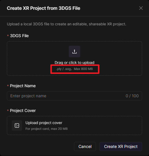

But .ply is supported in a different context: the XR Tour module.

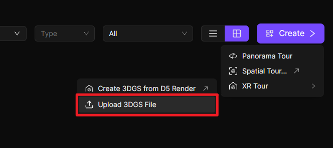

  • You can import .ply/.sog files into D5 XR Tour when creating an XR project (via Create > XR Tour > Upload 3DGS File),
Note: This is for 3D Gaussian Splatting (3DGS) point-cloud data, not for importing standard polygonal geometry into the main D5 Render scene.
