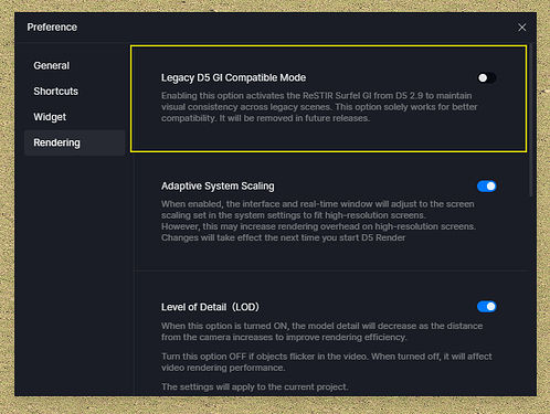

Try enabling Legacy D5 GI Compatible Mode. Enabling this setting will disable Path Tracing.
  • If the issue persists, we may need to collect your file. Although Anti-aliasing on thin objects and elements is known, disabling PT should alleviate this. Generate a link containing the file and send it to me privately.
