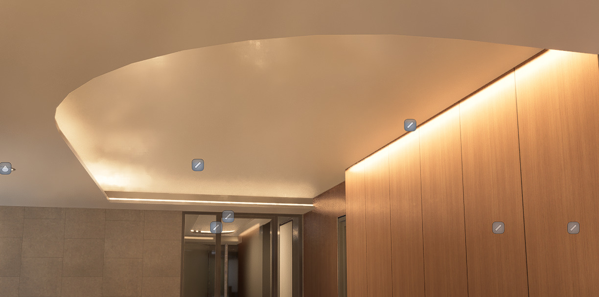

**Issue Description: my recent file of this project, suddenly the emissive material caused flicker in the preview, and affecting the still render
before
**Steps to Reproduce (optional): If i turned off the cast shadow on the emissive material, it was better, but the light intensity and effect will be different
anyway to solve this?
Thank you!
Tommy

somehow all those options are never turned on…
but those flickering emissive material, just suddenly appeared.
by the way i have 2 files with the same emissive material, one without flicker, and my recent ones started to flickered, i am not sure what caused it.
the only different with both files are the additional lights objects, but even after i turned off all the lights or the layers, the flicker still appeared.
by the way, i am working using sketchup for modelling.

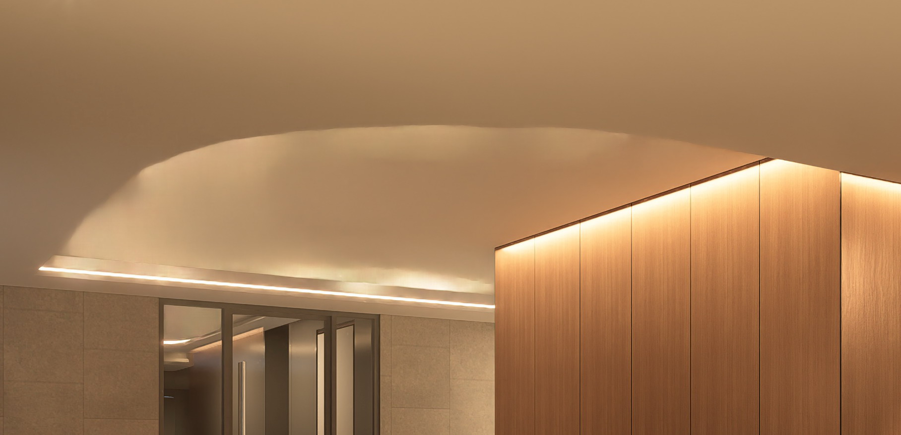

Hi Clov,
Thank you, but i beg to differ, the effect are significantly weaker, without “cast shadow” turned on, that’s why on my initial post, i have two different files preview, as you can see on the second image, the cove light using emissive material with cast shadow turned on were significantly brighter and much more contrast.

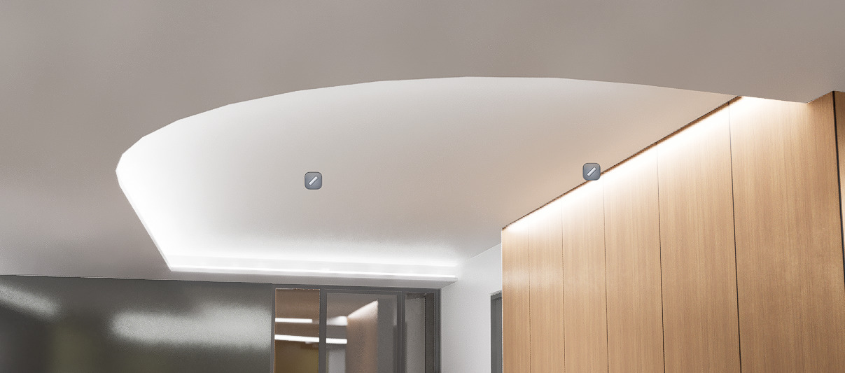

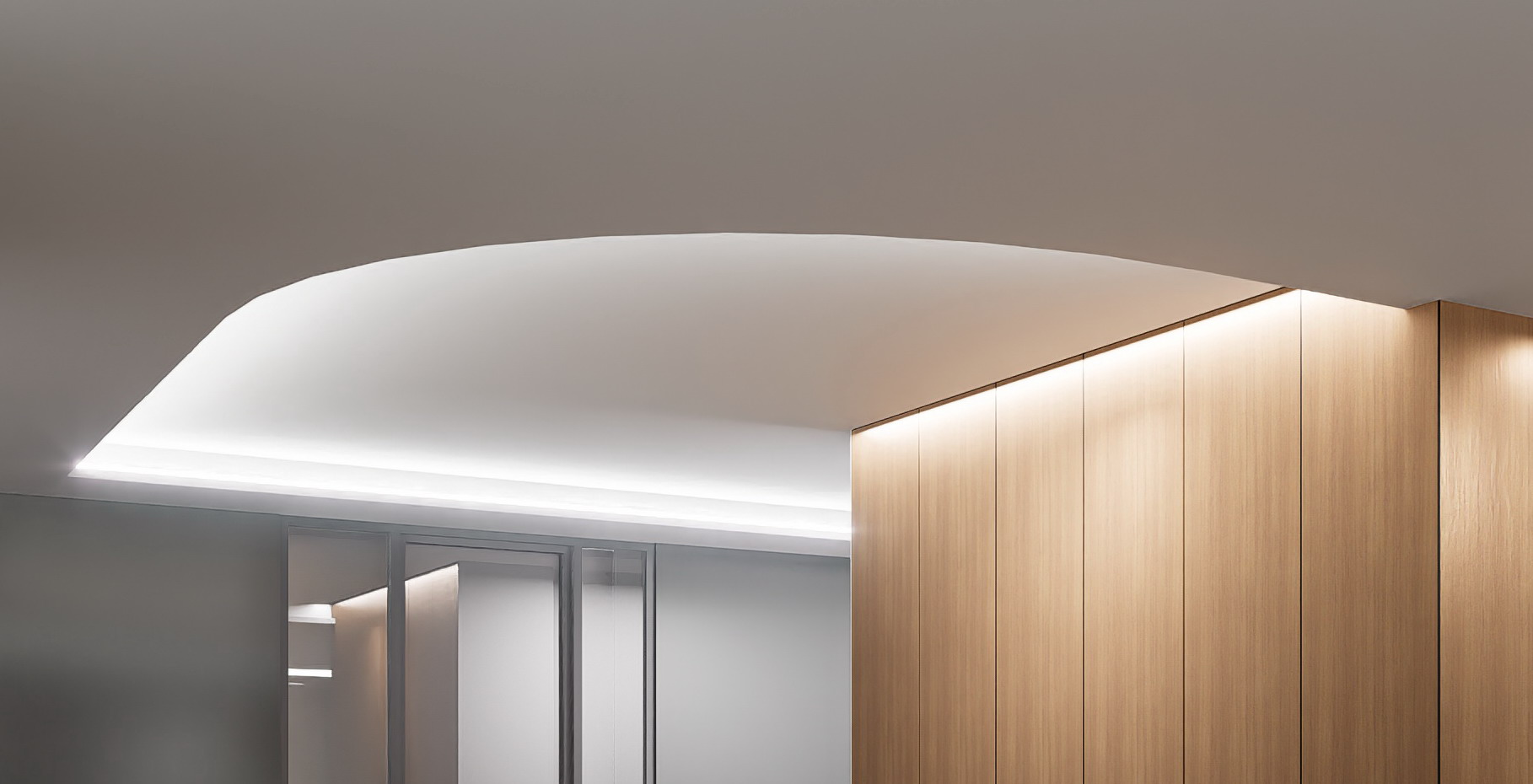

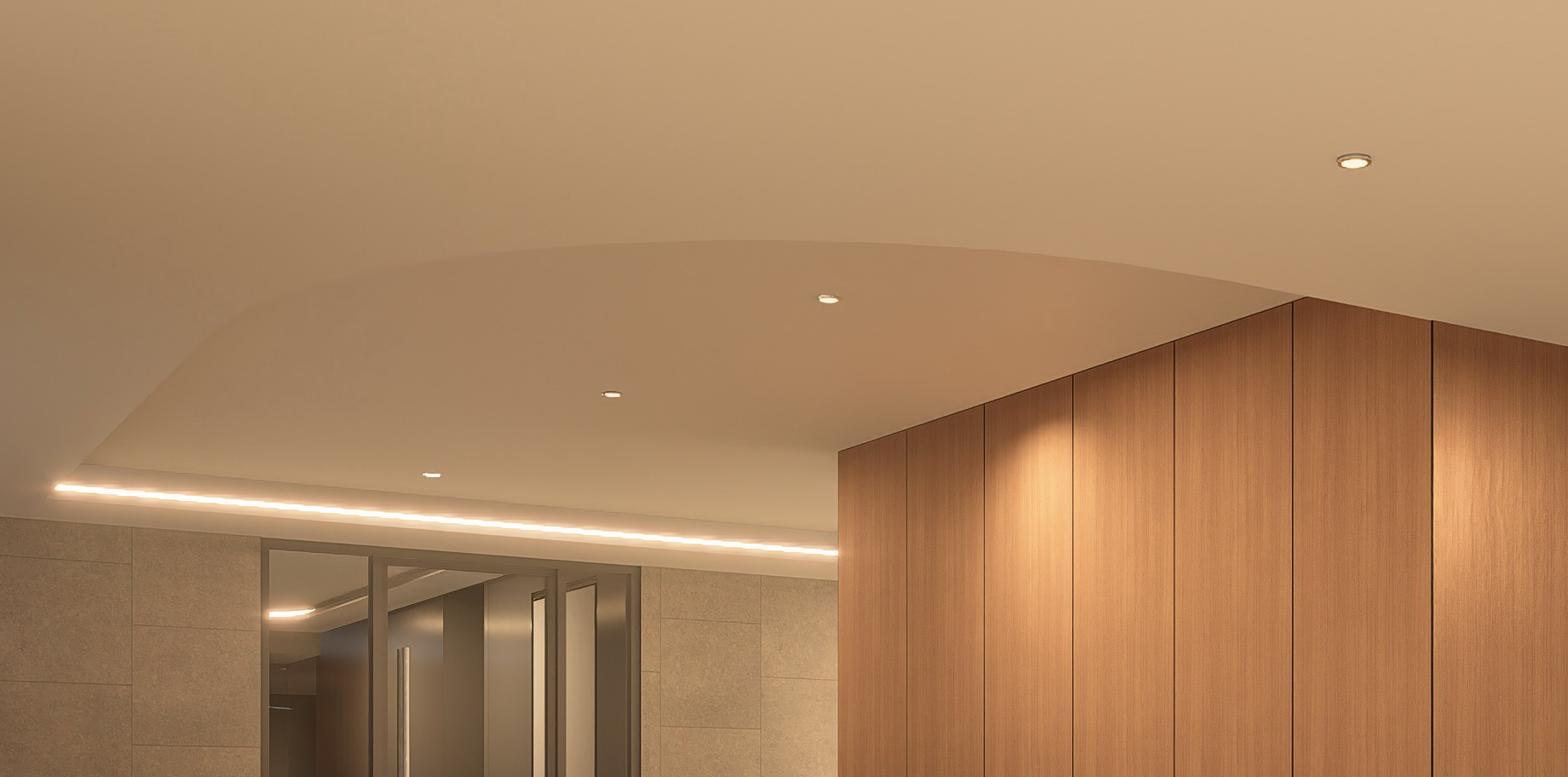

below are still render from two different files, from same 3D model, using same emissive material, with different temperature.
both using “cast shadow”, the first without flicker, second with flicker.
and this 3rd render, are same file as second render with “cast shadow” turned off
