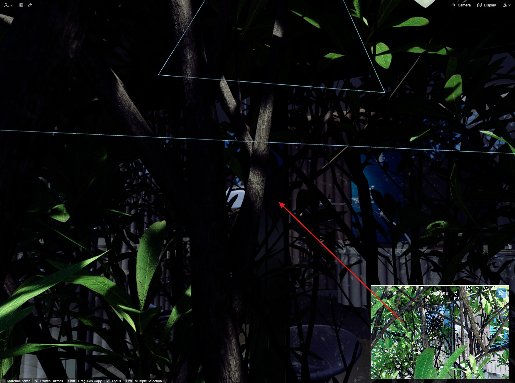

Effect Auto-Exposure doesn't match camera Auto-Exposure
Effect Auto-Exposure doesn’t match camera Auto-Exposure using the same values.
auto_exp.zip (3.5 MB)
It looks like Effect auto-exposure is way too less sensitive than Camera auto-exposure
Manual says that
but they are not linked at all except using scenes.
I thought that Effect exposure is a global exposure that affects all cameras but you can tweak it using individual camera exposures. Currently they override each other depends which one was used last. Strange.
Something very bad is with these two different exposure systems. They should be unified and works together.
Also camera auto exposure value is not saved in file. It reset to 0 every scene reloading.
Effect and Camera Auto-Exposure. The same values :
It looks like Effect auto-exposure doesn’t work.
Using Scene Camera it doesn’t work too until camera auto-exp slider is not clicked, activated :
autoexp.zip (3.7 MB)
Also Scene camera auto-exp value is reset to zero after scene reloading too. Completely not production ready feature at the moment.
Effect auto-exp completely doesn’t work compared to camera auto-exp :
a_exp.zip (2.9 MB)
Ok I found issue.
Camera auto-exp works fine in all scene conditions but it always produce too bright results like 0,4-0,7 exposure value. It take into account brightness of objects in view.
Effects auto-exp is buggy. Unlike camera auto-exp it take into account brightness of all objects in scene - not only in current view. This is why when project has many objects it completely doesn’t work.
Camera auto-exposure value is not saved in scene. It is reset to 0 after scene reloading.
