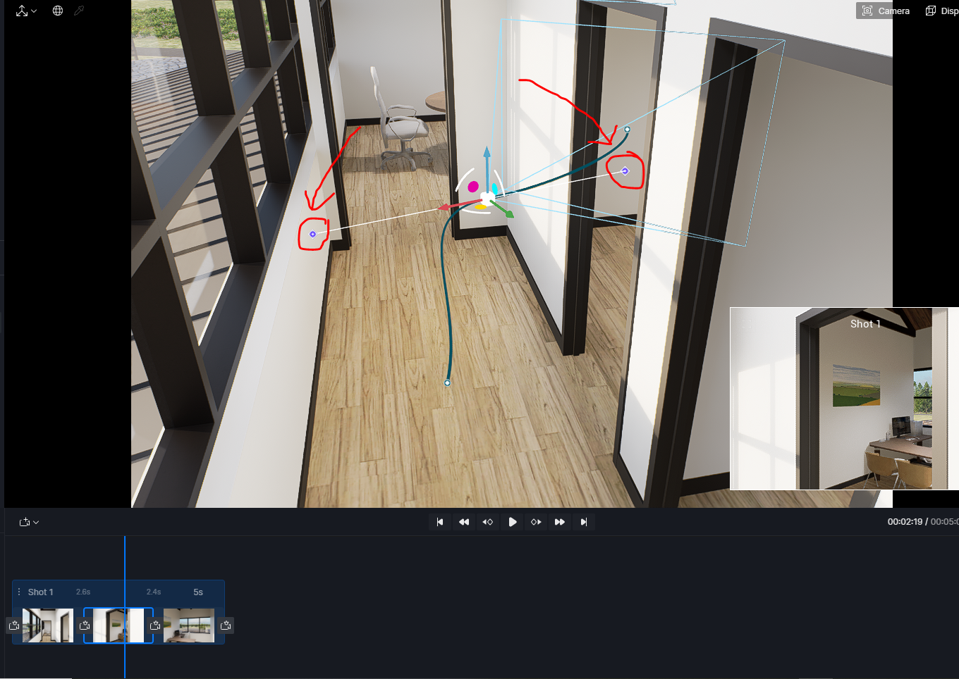

As in the attached image, none of the checkpoints can be selected.
It simply does not work in all its glory.

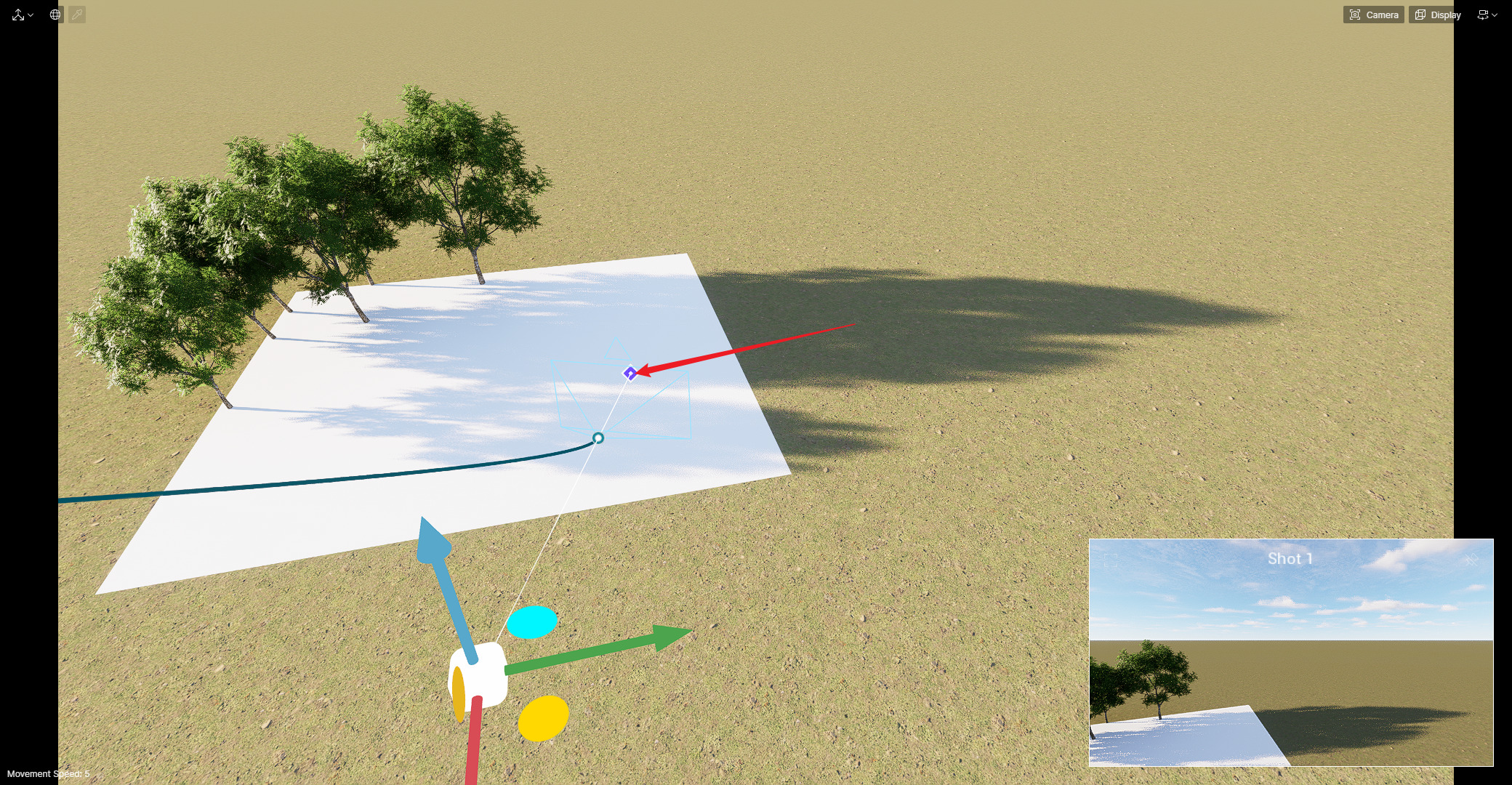

Edit Path Spline tool is not working on version 2.11
clicking on it doesn’t show the gizmo therefore not being able to tweak the curve.
Hi @urwone
Try to double click that point.
Gotcha! Thank you so much!
