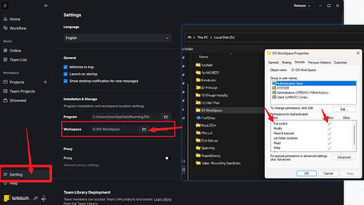

Hi @evrardaimerick
1. Can you please send us a screenshot of the location of your Workspace folder > Properties > Security
