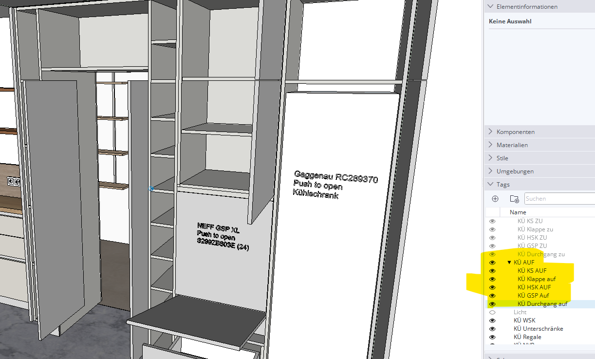

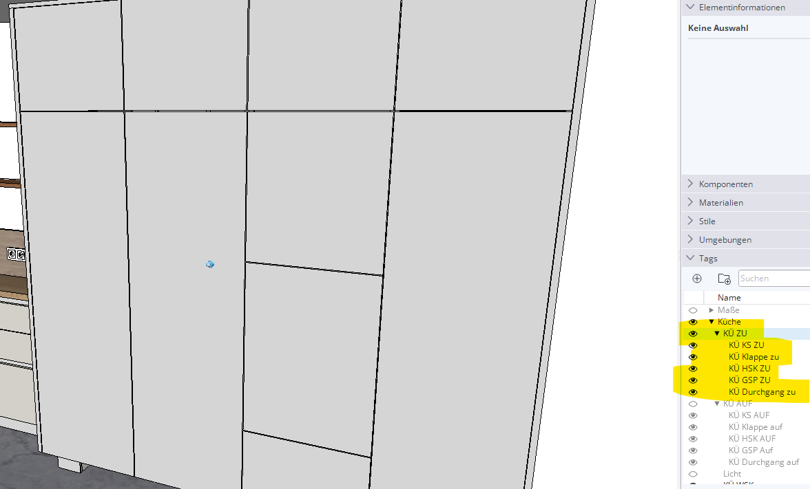

Hi Ela,
of course - see the attachment from skp
The first pic is closed i my kitchen group (closed dishwasher / closed doors and so on)
When I hide the group, all of the layers are hidden.
Further I can activate the group of “open” what you see in the second pic.
In D5 all layer was shown up and I was confused. I need to hide alle the layers manually. Not by click one group. Thats horrible for my workflow.
