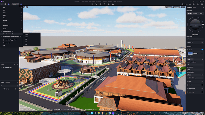

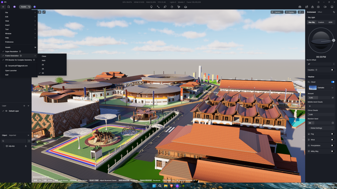

DLSS Frame Generation not working
**D5 Render Version: 3.0.1
**Graphics Card: RTX 5060TI 16GB
**Driver Version: 596.21
**Issue Description: Frame generation doesn’t seem to work. And I just get the same fps even on the 4x frame gen
