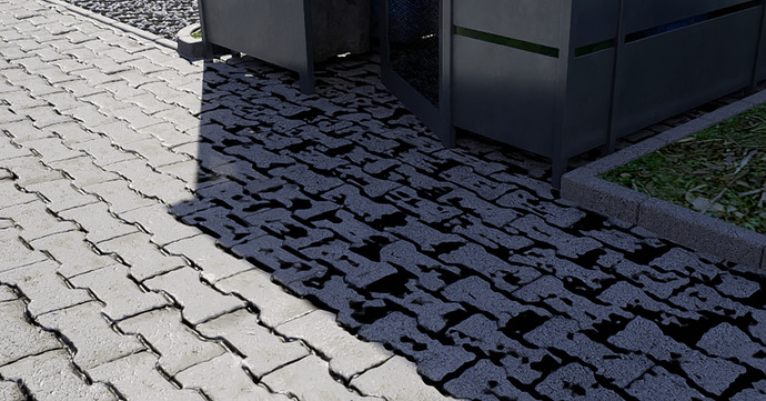

Displacement blotchy in shadow area

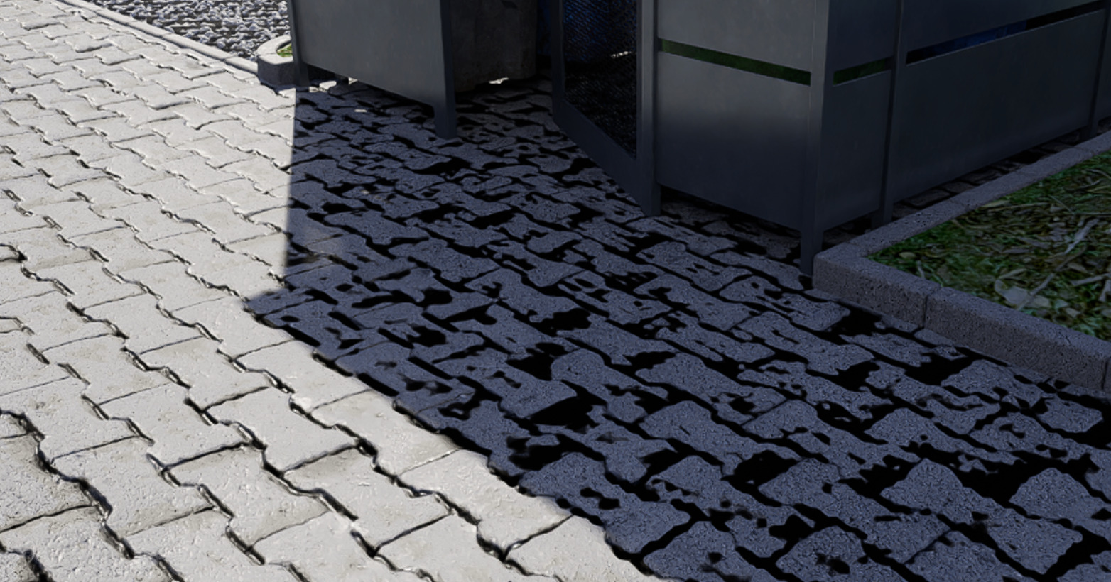

Displacement can be blotchy in shadow area
Hi @Smolak
That’s new. Can you send us this specific file? If not, you can try to isolate this portion.

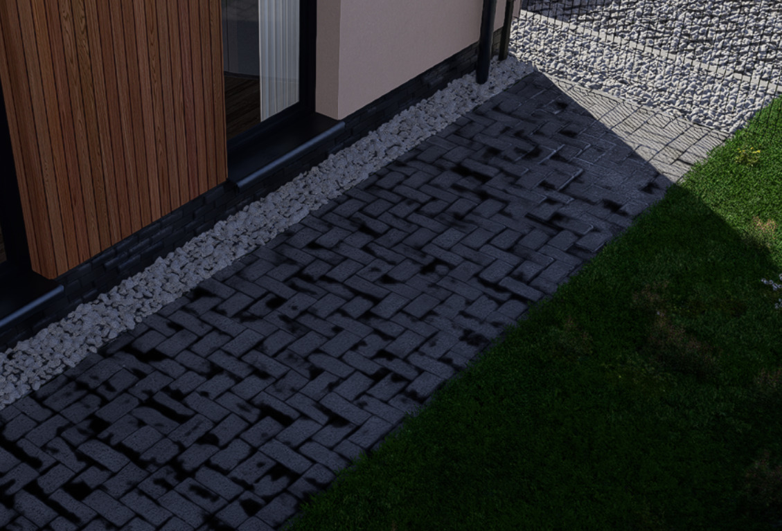

Strange. This issue is gone when I go to material manager. All displacement materials with blotches are rendered fine. Problem is that if I not go to material manager before final render, these badly blotches are visible on final render too.
disp_splotches (2).zip (1.6 MB)
disp_blotch (2).zip (1.2 MB)
I tried to replicate it on my end using another custom displacement material, with True displacement enabled. Let me know if you can’t share the file.
I will try to isolate this. I think that this is related to amount of geometry in scene.

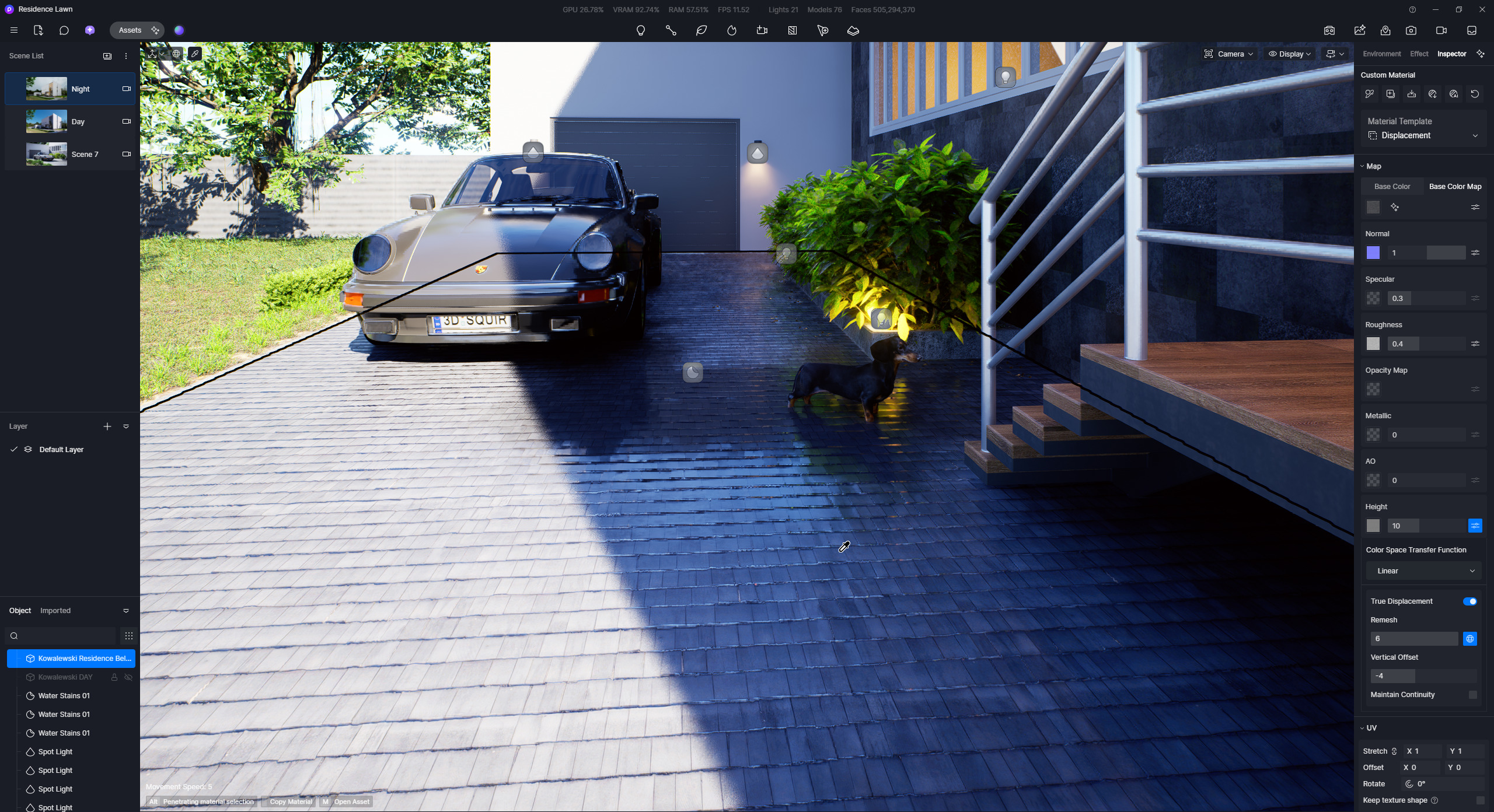

Another issue. After scene is growing displacement completely doesn’t work until I enter to material editing mode :
disp_bug (2).zip (2.7 MB)
disp_bug_2 (2).zip (2.3 MB)
