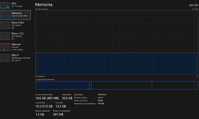

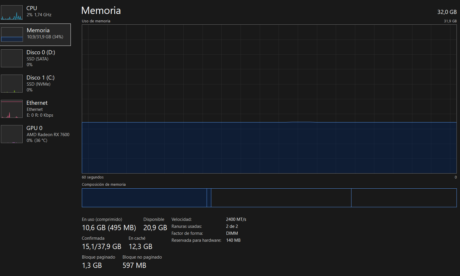

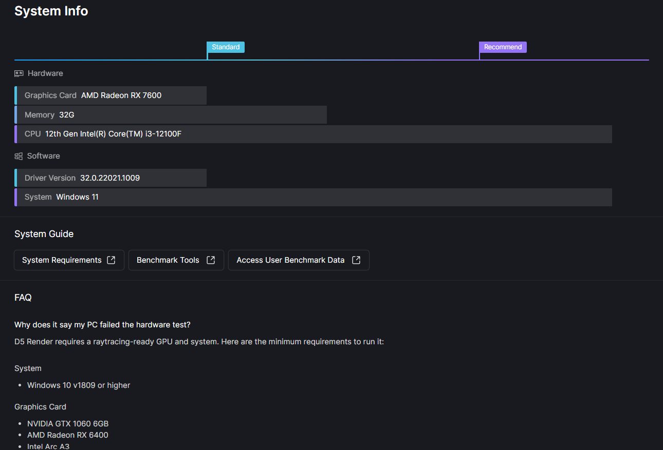

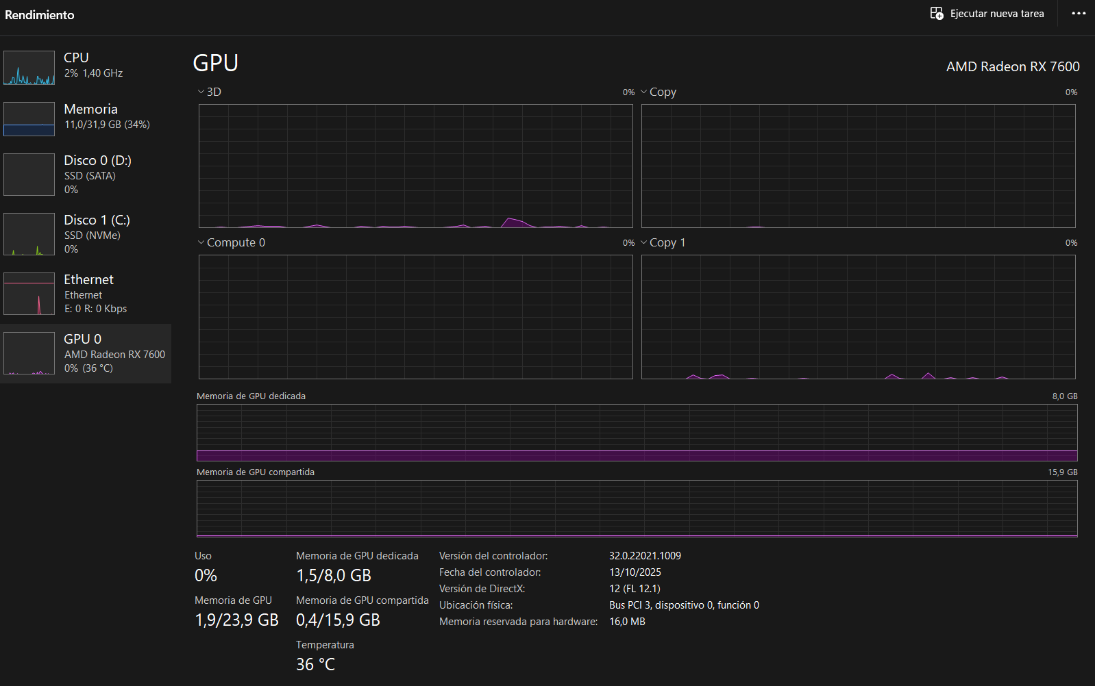

Que tal! Asi es, sucede desde un archivo simple hasta los mas complejos.Tambien sucede cuando quiero iniciar uno desde 0. Hace tiempo uso este software y solo paso luego de la ultima actualizacion…
Te dejo la informacion solicitada…
Gracias!
Hi @lucasdive2000
We recently posted a thread about AMD GPU Issues with specific Driver Version, please try to check the suggested solution in this post:
Additionally,
  • Have you tried reverting to 2.10.2 or the previous version just to check if D5 works normally?
  • Please check if you have enabled GPU Scheduling; If yes, disable it.
If the issue persists, please let me know. I may need to collect your log files and video recording.
