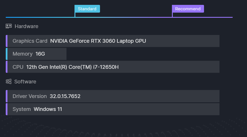

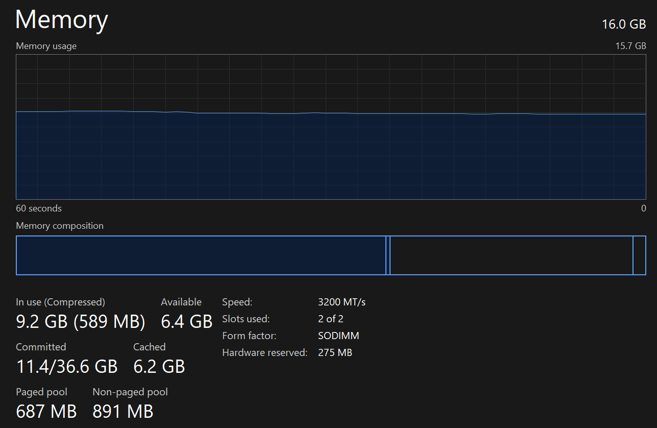

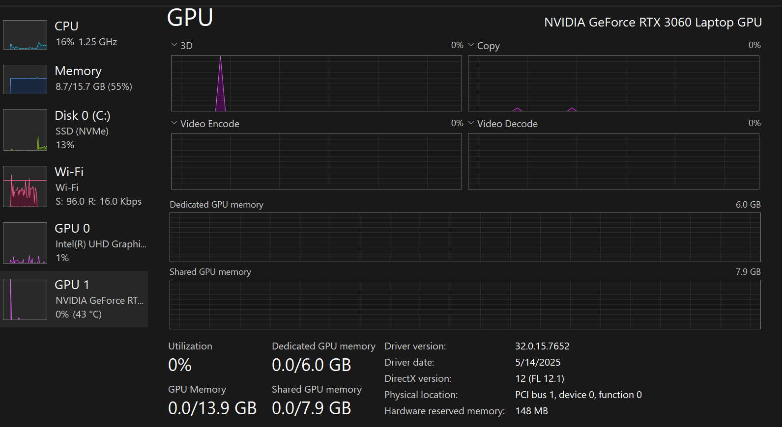

So you’re using D5 Render Version 2.7 still? Can you also send us the following images:
So, I have tried a few things i think i should mention.
I tried to re install older versions (I installed every version back to 2.3) and still the software is not usable. Now upgraded to 2.10. I started observing decline in performance a couple of months ago so I thought it was my graphics card vs the updates or something.
Attached are the data asked for.
@Clov is there any solution?
Thank you in advance.

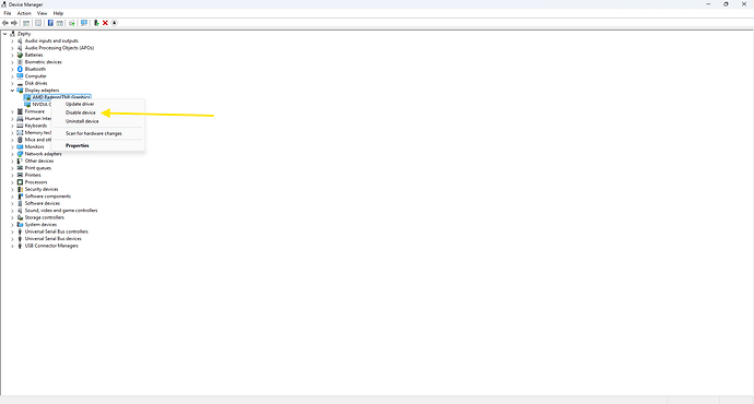

[Update] Based on the screenshot that you have provided, if it was opened with a D5 Render file, then it seems that your device is utilizing your iGPU (Intel) instead of your dedicated GPU (RTX). D5 needs to utilize the RTX card otherwise, you may run into some performance issues.
There are ways to address this:
  • You may want to try to disable your iGPU
  • Another option is to set D5 to use RTX GPU in NVIDIA Settings.
