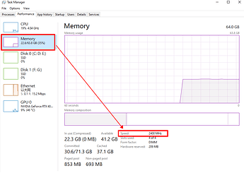

  • Please send me a screenshot of your Memory Speed and VRAM

I apologize for the inconvenience. Can you share to us the following images:
