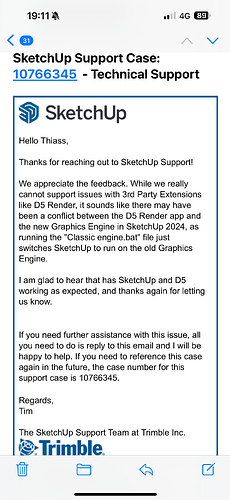

Hi,
Good news, I found the origin of the problem, so I share:
Issue with Sketchup not starting due to a windows update:
Crash #587744
We are investigating a recent Windows update for incompatible with the new SketchUp Graphics Engine. While we investigate, we recommend reverting to the Classic Graphics Engine.
This can be done in SketchUp by going to Window > Preferences > Graphics > Graphics Engine.
If you are unable to launch SketchUp to make this change, you can use the linked tool below to automatically update your preferences.
1) Close out of all instances of SketchUp and LayOut. If SketchUp is running this will not work.
2) Download the zip file below and extract the Classic engine.bat file.
3) Right click on the file and choose “Run as Administrator”. This will automatically update the SketchUp preferences to use the Classic Engine.
Classic engine.zip - Google Drive
If you need assistance with the steps above or continue to experience crashing please reach out to our support staff at: https://help.sketchup.com/en/contact-support/technical-question/form
Then I inform Sketchup technical service as I do here with my “frenglish” :):
“Hi,
Very interesting, thanks to this issue with a windows update I could find the origine of a problem I have for more than 6 months using D5 render for my finals renders project, used with my Sketchup studio license.
To resume, for 6 months now I was oblige to work with only 1 sketchup window open (more sketchup windows opened influence to D5 render who start not working properly and became unpraticable).
So with this issue, Sketchup did not start, I execute the classic engine.bat, Sketchup re-works.
I directly did a test with 3 sketchup files open and D5 render active, all was working perfectly as in the past (D5 fluent and workable).
So maybe something to take into account to find the origine of this problem.
I share the same message with D5 team,
Have a nice week-end”

Hi,
Yes it solves the issue, not activating Sketchup graphic engine but staying with classic solve the issue.
Regards
