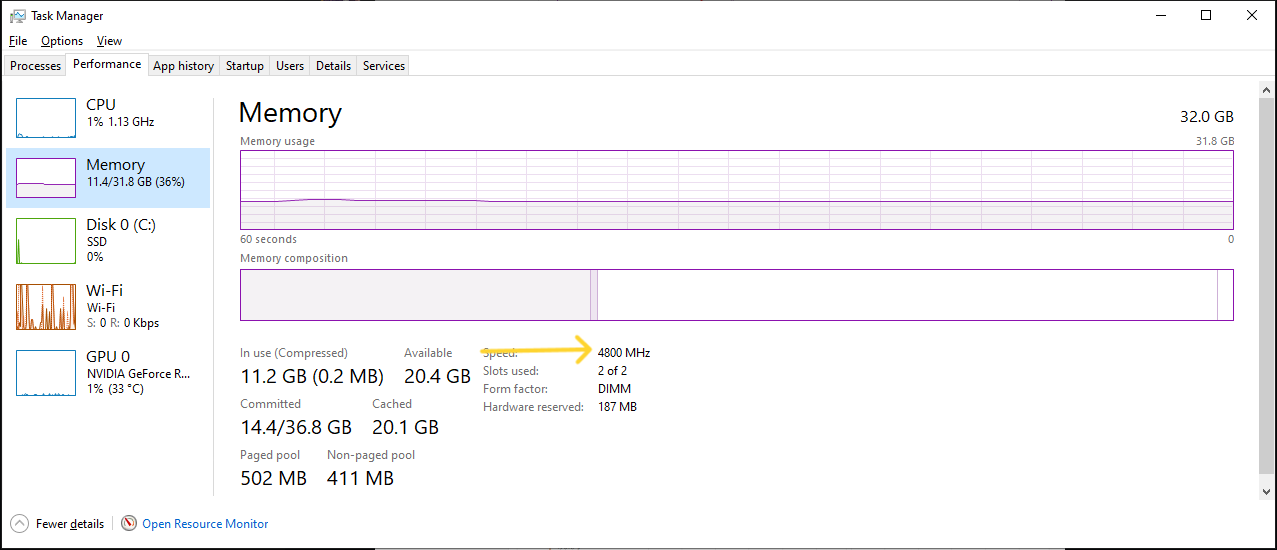

Additionally, we do recommend having a maximum Memory Speed of 4000 Mhz, this is to prevent D5 from crashing. Although 4800 Mhz is still “acceptable”, it may be worth trying to reduce its speed. You could go to BIOS and turn off XMP to change the memory speed or try to update the BIOS version. https://youtu.be/h-MLhGMtheM?si=U5usadsmYwEfYaA1
Updating your Graphics Card Driver may also be beneficial in the long run.
I tried what you said and it didn’t worked. Also we tried on 4 other computers with my friends and It was the same problem. Maybe this problem is something with the new version 2.10 of D5. When is coming out the 2.11 version?
