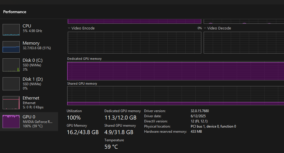

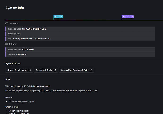

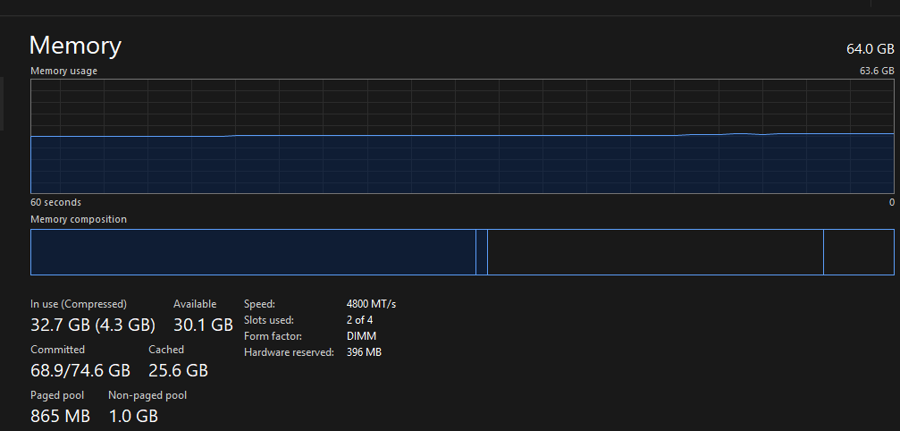

You might also want to send us the following images to check:
Same problem with the latest update, even with an RTX 5070, it takes twice as long to render the same video, in fact I uninstalled the latest version and installed a version twice as old and the rendering times are normal.
Kindly listen to the community as this is not an isolated issue.
D5 2.11 has double the render time

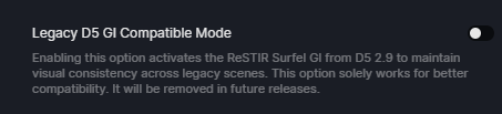

  • We are aware of this performance difference. If the rendering speed in 2.11 is not acceptable for your workflow, you can enable “Old GI Compatibility Mode” under Preferences → Rendering.

I was also under the impression the ability to toggle to the old GI was temporary and won’t be available in the future. Is that not correct?
But also, my point was that the ability to toggle quickly between the legacy GI and the new path tracer (especially for video) would be a welcome addition to the UI instead of burying it within the settings menu. My client project walk-through’s for video with the path tracer are far too long so I personally need to enable the legacy GI for video. It’s a substantial hit to renter time, particularly with video.

I don’t think the D5 Legacy option will be removed in the future.
The UI subtext on the current GI toggle states it’ll be removed in the future.
