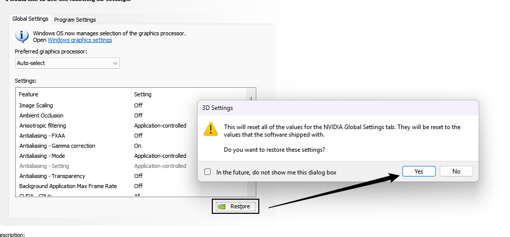

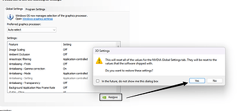

  1. Try to update your NVIDIA Drivers, then reopen your file.
  2. Another thing to check is your NVIDIA Control Panel, try to reset the global settings and make sure D5 is using High Performance.

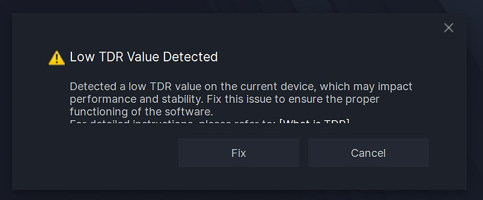

After receiving your suggestions, I updated my NVIDIA drivers as advised. However, since doing so, I’m now encountering a new issue when trying to open D5 or the file. I receive the following error:
Low TDR value detected.
Detected a low TDR value on the current device, which may impact performance and stability. Fix the issue to ensure proper functioning of the software.
I’ve now managed to work around the TDR warning by launching D5 as administrator and restarting my PC. That error no longer shows up but the scene still won’t open, which brings me back to the original problem.

If you were referring to the Low TDR Value issue, I’ve attached the relevant screenshots here. However, I was able to bypass that issue using a workaround, and it hasn’t appeared again since then.
