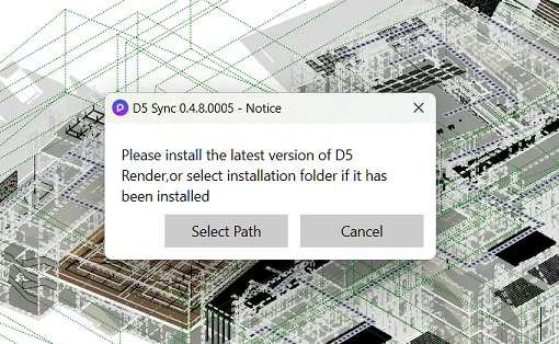

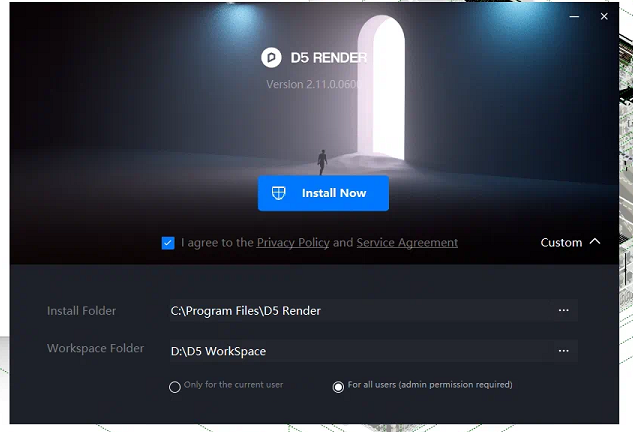

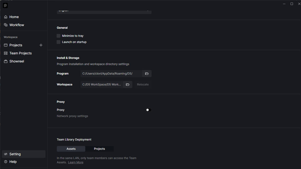

I installed the latest d5 render desktop, and revit plugin for the Real-Time Rendering for Revit with D5 Render. When I click start D5 on Revit I get the pop up " D5 sync 0.4.8.0005 - Notice Please install the latest or select the installation folder if it has been installed." I found the installation folder C:\Program Files\D5 Render, selected it and keep getting the same popup. I preformed a clean reinstall and still getting the same error.

Hi @hryerson

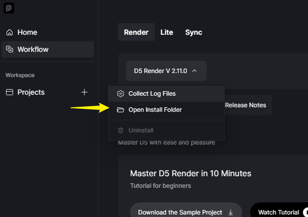

Please check your D5 2.11 installation path in this portion, and make sure this is the same address that you have selected in the Revit plug-in. The new Revit plug-in version will require 2.11.
Or you can try to uninstall everything (D5 Render, Launcher, and Plug-in) and do it again. You may do it in this manner:
  1. Versions after 2.11 require the installation of D5 launcher before downloading - Please download the launcher first before downloading 2.11
  2. Open D5 Launcher > Click the download button on D5 launcher homepage, select the download location, download and install.
3

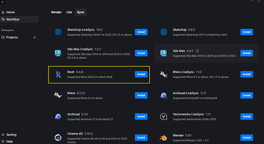

  1. After downloading D5 Launcher and 2.11, download the plug-in in the workflow section of the launcher.
Note: If you have other versions of d5 installed, please uninstall them or perhaps make sure that revit reads the 2.11 version.
Thank you for the response. Got it up and working now.
