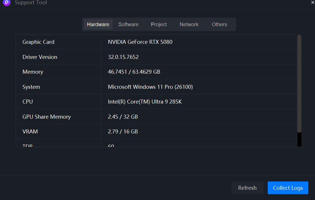

  • CPU : Intel Core Ultra9 285k
  • Graphics Card: RTX 5080
  • Power Supply: 1000W
  • D5 Render latest version

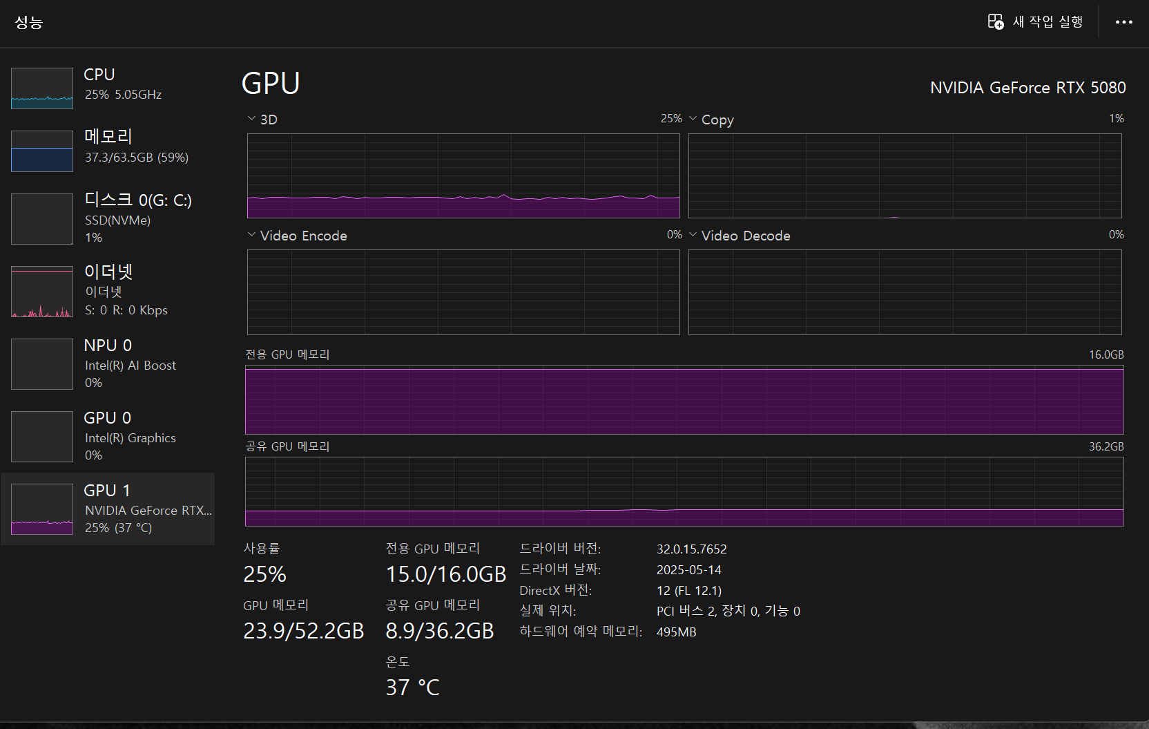

  • GPU VRAM usage: Close to 100% (when start video render)
  • GPU-Z Board Power Draw: About 100W (normal is 300–360W), (when start video render)

  • The program crashes (force closes) immediately after clicking the Video Render button (even it was 720p)
  • Occasional freezing during work
  • GPU-Z shows abnormally low power consumption during the crash

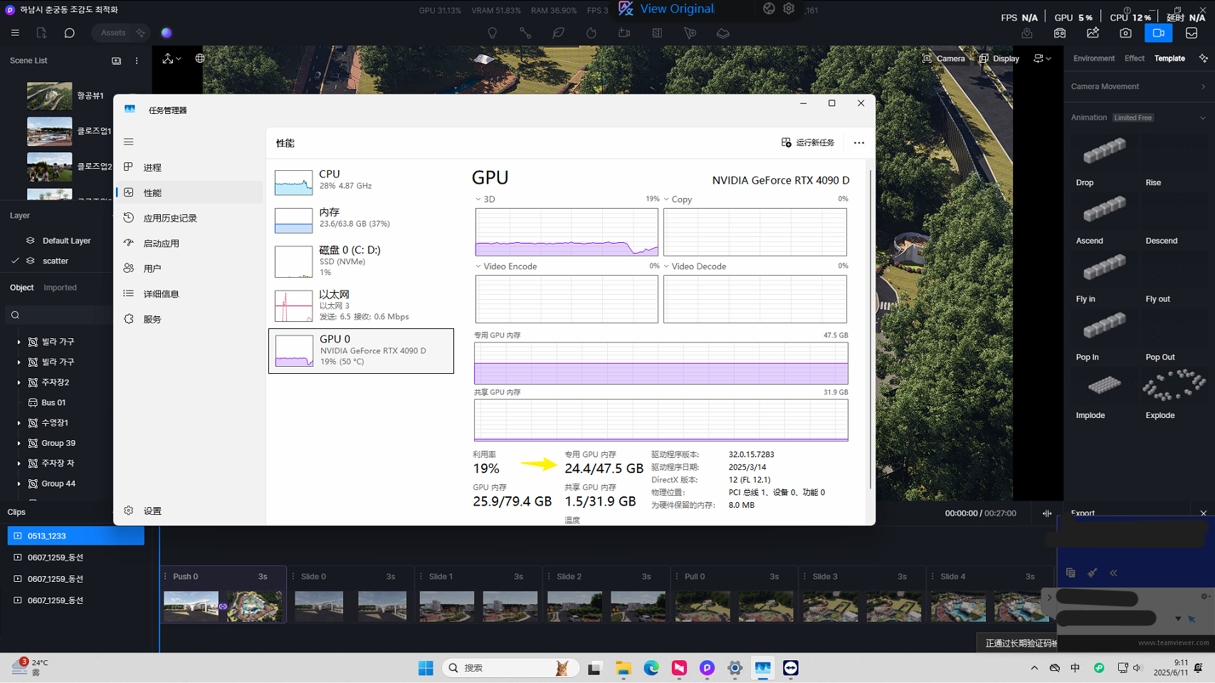

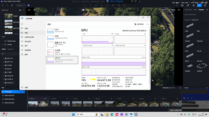

We were able to test your file on our end and there were no crashing that occurred upon clicking the video icon.
  • The device we used for testing your file has a large VRAM which we suspect, the reason why it didn’t crash on our end. The VRAM is at 24.4 GB which has exceeded your device’s VRAM which may have caused the crash. Video memory determines the performance of handling complex scenes.
  • I’ve also tried hiding all of the assets but there were no significant changes in the VRAM’s value unless the main model is hidden. Thus, it’s best to try to optimize your model and reduce the number of polygons. You may also want to try to separate the Main Model from the Models surrounding the structure by directly importing them separately.
